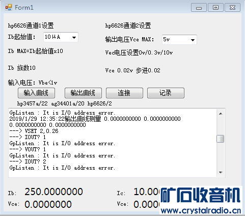

输出曲线测量程序:
'输出曲线测量设定
        Private Sub bt_output_Click(sender As Object, e As EventArgs) Handles bt_output.Click
        Dim Ibcurrent As String
        Dim VbeVoltage As String
        Dim Iccurrent As String
        Dim VceVoltage As String
        Dim Ib As String
        Dim Vce As String
        SendCommand("ISET 1," & Initial & ";VSET 1,1;ISET 2,0.5 ;VSET 2,0.02", 2)
        SendCommand("OUT 1,1;OUT 2,1;OUT 3,0;OUT 4,0", 2)
        Sleep(200)
        For j = 1 To 10
            Ib = j * Val(Initial)
            SendCommand("ISET 1," & Ib, 2)
            Sleep(200)
            For i = 1 To Val(VceMax) Step 0.02
                Vce = i * 0.02
                SendCommand("VSET 2," & Vce, 2)
                Sleep(200)
                SendCommand("IOUT? 1", 2)
                Ibcurrent = ReadValue(2)
                Sleep(200)
                SendCommand("VOUT? 1", 2)
                VbeVoltage = ReadValue(2)
                Sleep(200)
                SendCommand("IOUT? 2", 2)
                Iccurrent = ReadValue(2)
                Sleep(200)
                SendCommand("VOUT? 2", 2)
                VceVoltage = ReadValue(2)
                Sleep(200)
                Label3.Text = FormatNumber(CStr(Ibcurrent), 7)
                Label2.Text = FormatNumber(CStr(Iccurrent), 7)
                Label11.Text = FormatNumber(CStr(VceVoltage), 7)
                Label4.Text = FormatNumber(CStr(VbeVoltage), 7)
                Record.AppendText(Now & "输出曲线测量 " & FormatNumber(CStr(Ibcurrent), 10) & " " & FormatNumber(CStr(VbeVoltage), 10) & " " & FormatNumber(CStr(Iccurrent), 10) & " " & FormatNumber(CStr(VceVoltage), 10) & vbCrLf)
                Record.ScrollToCaret()
                fLog.WriteLine(Now & " Ib:Vbe:Ic:Vce " & FormatNumber(CStr(Ibcurrent), 10) & " " & FormatNumber(CStr(VbeVoltage), 10) & " " & FormatNumber(CStr(Iccurrent), 10) & " " & FormatNumber(CStr(VceVoltage), 10))
                fLog.Flush()
                ' Sleep(500)
            Next
            fLog.WriteLine(" 输出曲线测量 Ib= " & Ib)
            fLog.Flush()
        Next
    End Sub

Label还是不显示,把延时删除了运行速度快多了,这个模块有问题运行结束死机,输入加10Ω电阻照旧,电源精度1μA,偏差这么大,需要校准?
补充内容 (2019-1-29 07:55):
在办公室把消息框屏蔽 Label 不显示数据,运行结束软件陷入死机。
补充内容 (2019-1-29 10:19):
运行结束软件陷入死机,原因查到,减少循环次数就没有这个问题,这怎么办?

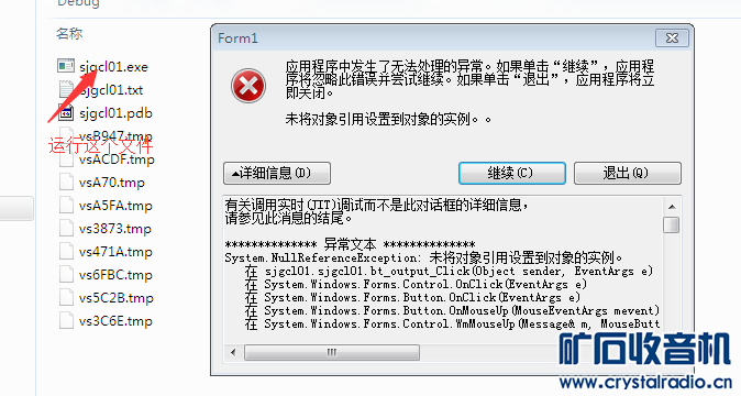

运行生成.exe文件出现错误提示:应用程序发生异常,消息框内容是:有关调用实时(JIT)调试而不是此对话框的详细信息,请参见此消息的结尾。
问题找到了关闭消息框出现的问题,把消息框关联都关了问题就没有了,显示还是老问题。结束显示最后一行

电源电流档误差原因也找到了,电流范围是0.5a,g改为15ma,设定10μa,读数和手持万用表读数接近12μa偏差2μa递增10μa,偏差小于1μa.
补充内容 (2019-2-1 14:38):
Label.text不显示原来例程抄不到,摸索增加Label.Refresh()控件刷新可以了。现在软件多重循环运行稳定性有问题大多遇到其它软件运行或鼠标动作造成运行死机。

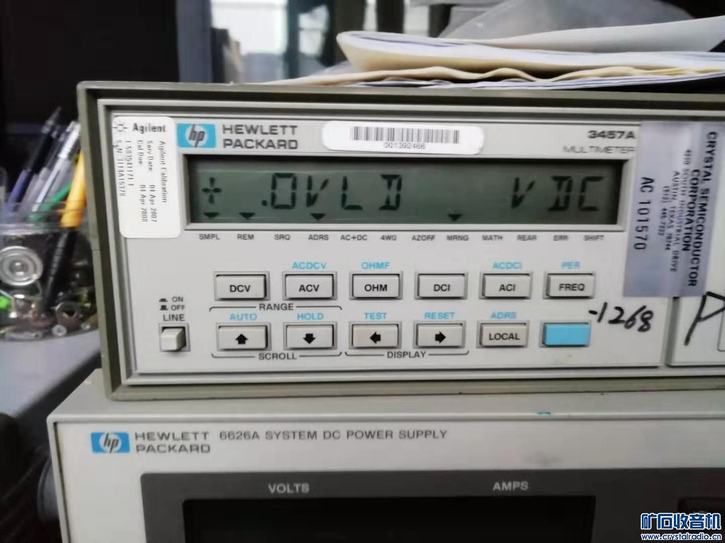

washu 老师好,我用4个bz3串联接hp6626a恒流,在用HP3457a的 44491卡(去掉了MMCX 端子适配器,直接用网线连接),上位机分别测量每个 bz3电压并记录,采用100plc,测量转换后端卡,测量记录都有动作,出现表测量溢出现象(我的理解),
在每个选择通道测量功能和触发指令后面加Sleep(1000)也不行。
34401a,测量出现100plc和位数选择不一致出现上面的情况,选择一致就解决了。
比葫芦画瓢就遇到困难了
 楼主| 发表于 2019-10-9 07:53:19 | 显示全部楼层
HP3457a 44491卡上位机问题找到了,没有设置使用44491卡,TERM2; ,给的示例有,给忽略了。改完还没试,
