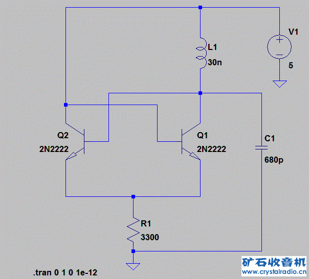

发表于 2011-6-27 03:12:36 | 显示全部楼层
I finally got it working.
here is my schematic.
L1 is the inductor you wish to measure. C1 is the capacitor that forms a lc tank with L1.
R1 determines the bias current for the oscillator.
Q1/Q2 forms an oscillator.
the key to this is to use a low R1: Yates used figures as high as 100K but I found out that mine oscillates reliably at under 10k.
I also found out that distributed capacitance / inductance is quite significant: without C1, and short L1, the circuit oscillates at around 20Mhz, all by itself.
enjoy.
 楼主| 发表于 2011-6-27 03:16:24 | 显示全部楼层
millwood 发表于 26/6/2011 11:12
    hmmmm,   it seems your picture is kinda transparent   :p
 楼主| 发表于 2011-6-27 05:48:33 | 显示全部楼层
L1 is the inductor you wish to measure. C1 i ...
       wow,  that work great under LTspice
如果用 2SC3355  2SC3356  BFR93A 这些微波管应该可以减小结电容的影响, 或者提高电源电压。

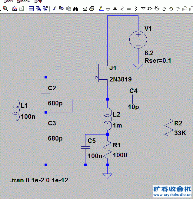

发表于 2011-6-27 07:23:37 | 显示全部楼层
it is a little bit simpler than the colpitts oscillator you posted earlier. However, because of the miller capacitance, it doesn't oscillate at as high of a frequency as yours does.
 楼主| 发表于 2011-6-27 07:43:15 | 显示全部楼层
it is a little bit simpler than the colpitts oscillator you posted earlier. However, because of the  ...
millwood 发表于 26/6/2011 15:23
              I'll build one in real when I have time.  The waveform seems to be better than that of the Colpitts.
发表于 2011-6-27 21:55:29 | 显示全部楼层
not sure. the wave form above 1Mhz is fairly sinuous. below 1Mhz, it is a square wave.

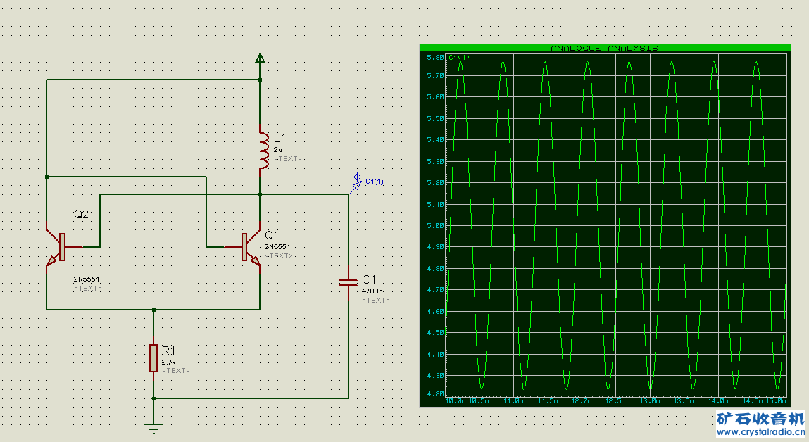

 楼主| 发表于 2011-6-29 04:44:12 | 显示全部楼层
      JFET 的波形为什么要好过 BJT 很多呢 ??
