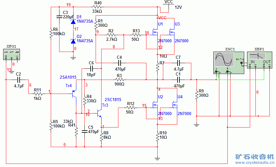

实做和仿真高性能低成本耳放 JLH (John Linsley Hood) 8V低压供电 补图
发表于 2010-8-16 22:22:19 | 显示全部楼层 |阅读模式
Many thanks to millwood for walking me thru such a long road!!
原贴地址:
http://www.crystalradio.cn/bbs/thread-134183-1-1.html
***  感谢原贴中诸位的回复和关注 !
最开始的原理图:
经过几天的琢磨,  第一次把理论 THD 降到 0.001% 以下时的原理图:

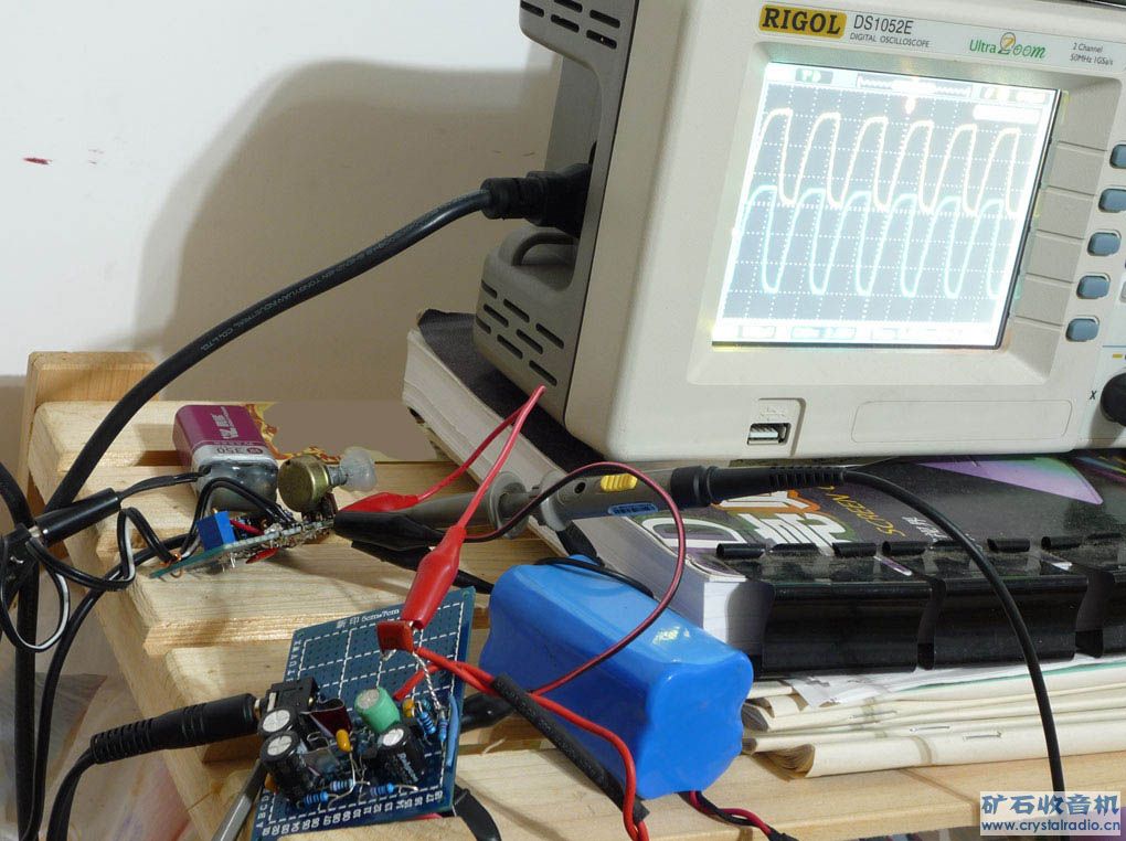

实物照片
波型:

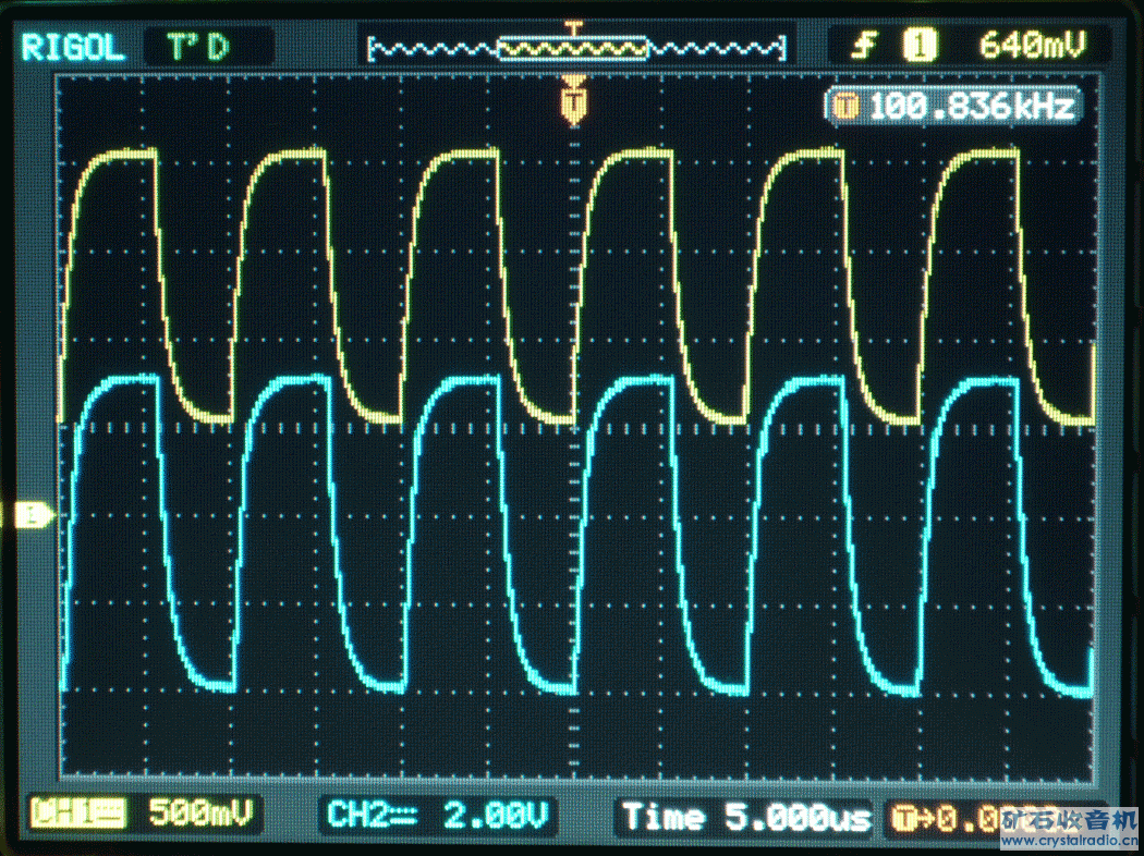

下面是波型,  黄色波型是输出, 蓝色波型是输入.
2am BJT Aug 17, 2010    增加了耳机插座,  剪掉了散热片, 测了一下 100KHz 的表现 (用 555 产生的 100KHz)
黄色是信号,  蓝色是输出.

发表于 2010-8-17 06:46:25 | 显示全部楼层
that 100Khz square waveform is telling:
1) no instability - no ringing at all. If anything, the amp appears to be slew limited.
2) slew rte of about 6v/2ns=3v/ns. pretty good and more than sufficient for a headphone amp.
I would be interested in how the amp reacts to overdrive / clipping.
also, how about a pair of small signal mosfets (irf510 or 2n7000) as the output device?

I dont have any 2n7000 or IRF510 on hand.  2n7000 is $?  EA
Yeah, I limited the slew rate by adding a 10pF cap parallel to the 900 ohm resistor.
Without the 10pF cap, there is ringing.
发表于 2010-8-17 21:33:54 | 显示全部楼层
if there is ringing, you can put a small cap, like 22pf - 110pf on the VAS's collector / base.
high speed amps are prone to ringing, due in part to their high speed and driving reactive loads - like long speaker cables, etc.
putting a small resistor on the output (in serial with the load) helps a lot.

          could you share the sch of the MOSFET version ?
发表于 2010-8-17 22:24:01 | 显示全部楼层
2n7000 is about a few cents each.
the mosfet version is identical to yours, except that the output devices are replaced with two mosfets, with gate stoppers (resistors < 110ohm on their gates). you will need to play with biasing a little bit.
If you are building a small headphone amp, you can use irf510 (my favorite medium power mosfets), without heatsink.
if you are building a large power amp (> 20w RMS), try IRFP140 or FQA25Nxx class mosfets in TO3P packaging.
发表于 2010-8-17 22:25:12 | 显示全部楼层
the good thing with JLH1969M is that it can run in Class A, Class AB or Class B. You can bias it in class A for smaller power (around 1W RMS for example) and if a large signal comes, it will smoothly transition into Class B.
No more expensive heat sinks.

It seems for the MOSFET version,  8 Volt supply (Li-BATT) is not sufficient ,  12 Volt (Car Charger Plug) is ok.

In mainland China,  2N7000 is around a quarter EA (1 RMB),  not cheap at all.   on the other hand, IRF610 is cheap, 2 RMB EA ( $0.35).
发表于 2010-8-17 23:36:28 | 显示全部楼层
you are correct that the mosfet version is less efficient, because of their larger Vds drop for linear applications. So consequently, you need higher rail voltage to achieve the same output swing.
发表于 2010-8-17 23:37:42 | 显示全部楼层

发表于 2010-8-18 01:11:54 | 显示全部楼层
didn't realize that.
another n-channel to try is bs170. less beefier but roughly the same.
you can also do a more generic search for mosfets with Ids in the 1 - 2amp range.
