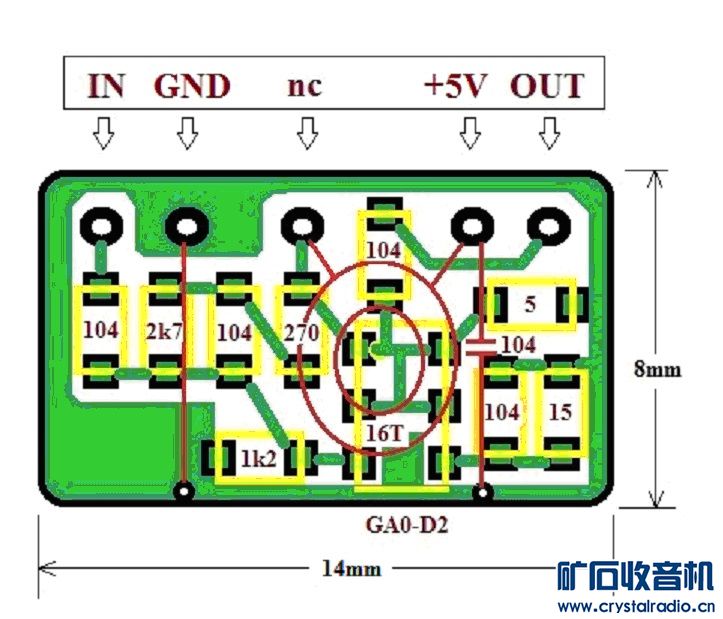

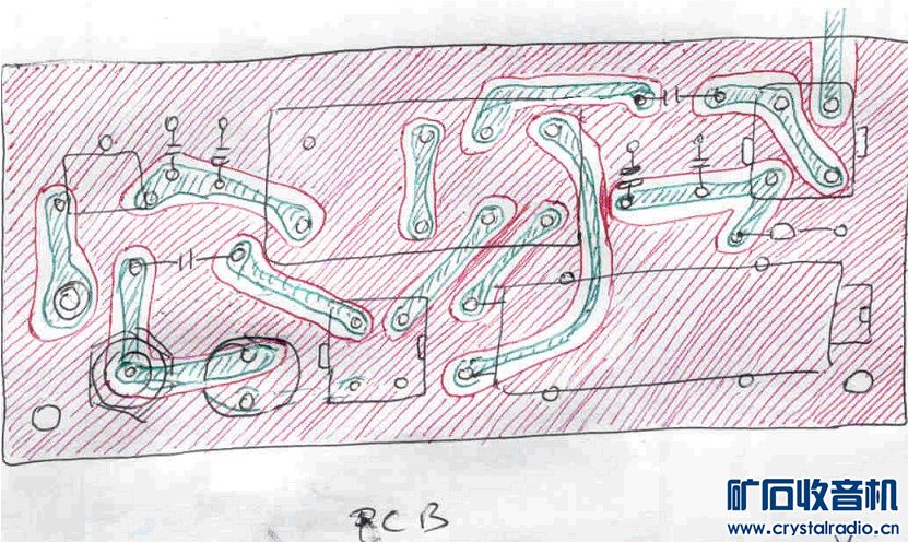

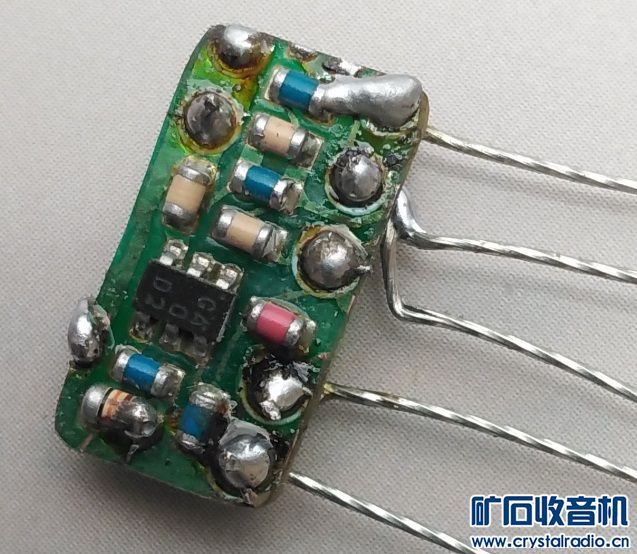

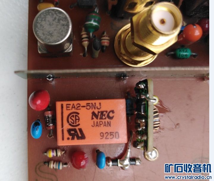

(9)高放(RF Amp)
这个高放是宽频的,位于接收机的前端,电路虽不复杂,但要做好它却花了很多心思。要求全频工作(100kHz~30MHz),较低的输入和输出阻抗(50欧),有一定的电压增益(大于15dB),超动态(强信号dBm级输入不阻塞),自身低噪音(弱信号dBu级接收不被掩盖),高线性(低的3阶互调产物)。试过2SC3358、BFR91、J212 JFET、2SK30 MOSFET、uPC1651G IC等多种线路,结果都不满意(无法通过仪器的严格测试),也试过6K4电子管,结果相当满意,最后从一个成品的0.1MHz~1.2GHz LNA放大器(指标:增益18.5dB,噪音低于2dB,动态6dBm)中拆下一个MMIC,印有GA0-D2,具体型号未知,装于一块14mm x 8mm的单面板上,去掉原来的SMD扼流电感,自制一个高频扼流圈装于背面。该电路的工作电压是5V,工作电流约28mA,实测电压增益为16.6dB(测试频率7.4MHz),全频段100kHz~30MHz的增益平坦度 –0.5dB ~ +0.5dB(超级稳定,没有寄生自激点)。加电时整个电路用继电器控制接入,不加电时电路为直通,不用人工/自动增益控制,避免在特殊无线电环境接收时可能产生的“诡异”现象。
电路:(已传)
PCB小板:
PCB:
安装:

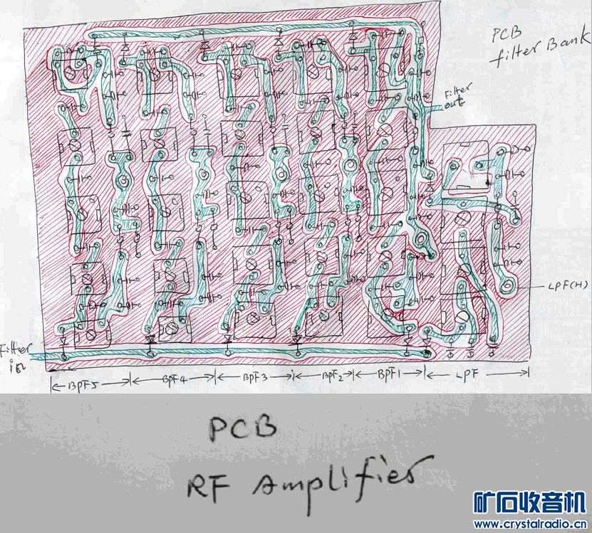

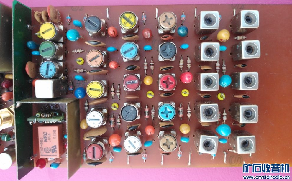

(10)输入滤波器(Input & Filter Bank)
电路:(已传)
50欧3~18dB 高频衰减器
50欧:50欧 Balun
滤波器组PCB:
滤波器“中周”的制作数据:
LPF0:L0–1,0.12mm,38T,  “10.7MHz中周”骨架,7.5 x 7.5 x 10mm(H);
L0–2,0.12mm,50T,  “10.7MHz中周”骨架,7.5 x 7.5 x 10mm(H);
L0–3,0.12mm,38T,  “10.7MHz中周”骨架,7.5 x 7.5 x 10mm(H);
L0–4,0.07mm,144T,“10.7MHz中周”骨架,7.5 x 7.5 x 10mm(H);
BPF1:L1–1,0.12mm,46T,  “10.7MHz中周”骨架,7.5 x 7.5 x 10mm(H);
             L1–2,0.12mm,38T,  “10.7MHz中周”骨架,7.5 x 7.5 x 10mm(H);
L1–3,0.12mm,24T,  “10.7MHz中周”骨架,7.5 x 7.5 x 10mm(H);
L1–4,0.12mm,38T,  “10.7MHz中周”骨架,7.5 x 7.5 x 10mm(H);
L1–5,0.12mm,46T,  “10.7MHz中周”骨架,7.5 x 7.5 x 10mm(H);
BPF2:L2–1,0.12mm,26T,  “10.7MHz中周”骨架,7.5 x 7.5 x 10mm(H);
             L2–2,0.12mm,28T,  “10.7MHz中周”骨架,7.5 x 7.5 x 10mm(H);
L2–3,0.12mm,14T,  “10.7MHz中周”骨架,7.5 x 7.5 x 10mm(H);
L2–4,0.12mm,28T,  “10.7MHz中周”骨架,7.5 x 7.5 x 10mm(H);
L2–5,0.12mm,26T,  “10.7MHz中周”骨架,7.5 x 7.5 x 10mm(H);
BPF3:L3–1,0.12mm,21T,  “10.7MHz中周”骨架,7.5 x 7.5 x 10mm(H);
             L3–2,0.12mm,19T,  “10.7MHz中周”骨架,7.5 x 7.5 x 10mm(H);
L3–3,0.12mm,12T,  “10.7MHz中周”骨架,7.5 x 7.5 x 10mm(H);
L3–4,0.12mm,29T,  “10.7MHz中周”骨架,7.5 x 7.5 x 10mm(H);
L3–5,0.12mm,21T,  “10.7MHz中周”骨架,7.5 x 7.5 x 10mm(H);
BPF4:L4–1,0.12mm,44T,  “38MHz中周”骨架,7.5 x 7.5 x 12mm(H);
             L4–2,0.12mm,36T,  “38MHz中周”骨架,7.5 x 7.5 x 12mm(H);
L4–3,0.12mm,25T,  “38MHz中周”骨架,7.5 x 7.5 x 12mm(H);
L4–4,0.12mm,36T,  “38MHz中周”骨架,7.5 x 7.5 x 12mm(H);
L4–5,0.12mm,44T,  “38MHz中周”骨架,7.5 x 7.5 x 12mm(H);
BPF5:L5–1,0.12mm,30T,  “38MHz中周”骨架,7.5 x 7.5 x 12mm(H);
             L5–2,0.12mm,25T,  “38MHz中周”骨架,7.5 x 7.5 x 12mm(H);
L5–3,0.12mm,17T,  “38MHz中周”骨架,7.5 x 7.5 x 12mm(H);
L5–4,0.12mm,25T,  “38MHz中周”骨架,7.5 x 7.5 x 12mm(H);
L5–5,0.12mm,30T,  “38MHz中周”骨架,7.5 x 7.5 x 12mm(H)。
安装:
输入电路PCB:
安装:

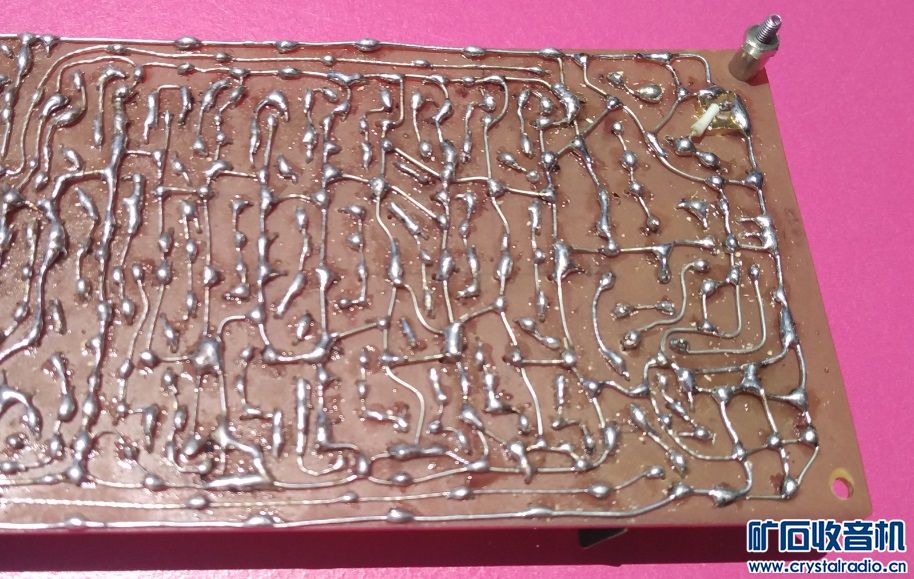

PCB:
没有花时间去优化线路板的设计,单面板布线草图,有20多根条跳线,惭愧,凑合着用了。
组装:

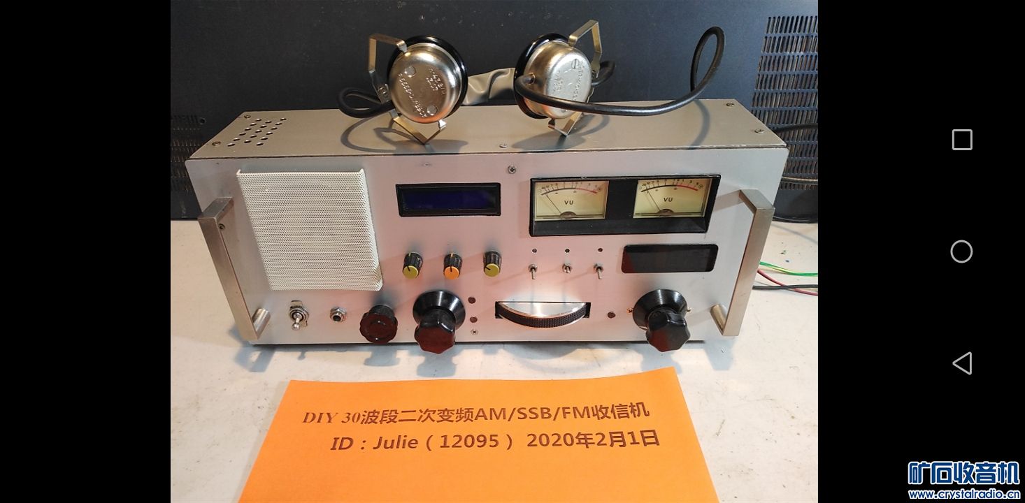

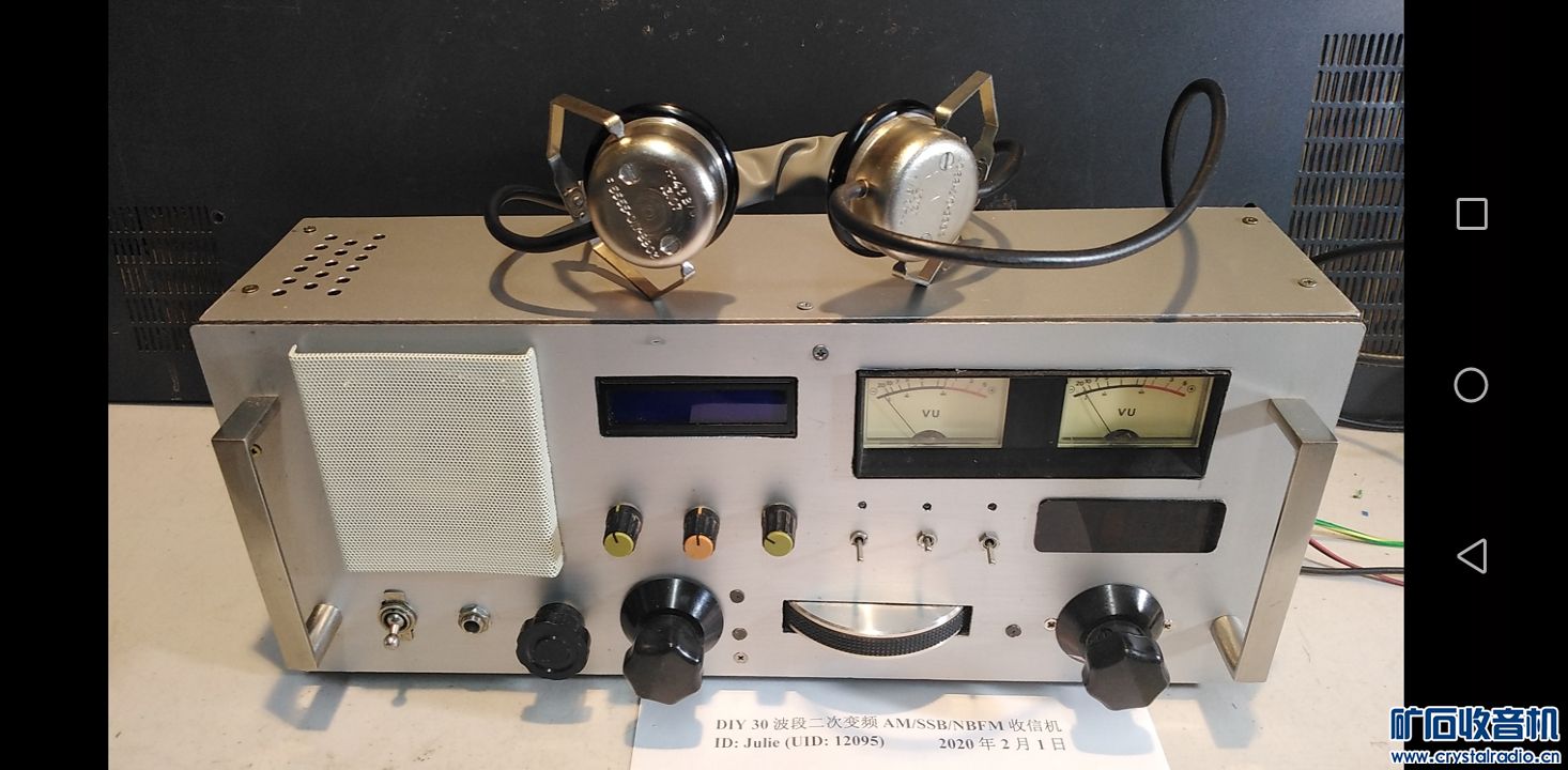

(四)整机总装
数字控制板:(已传)
屏蔽板:(已传)
接收电路主板:(已传)
最后装上VU表的驱动小板:
补充完毕。
