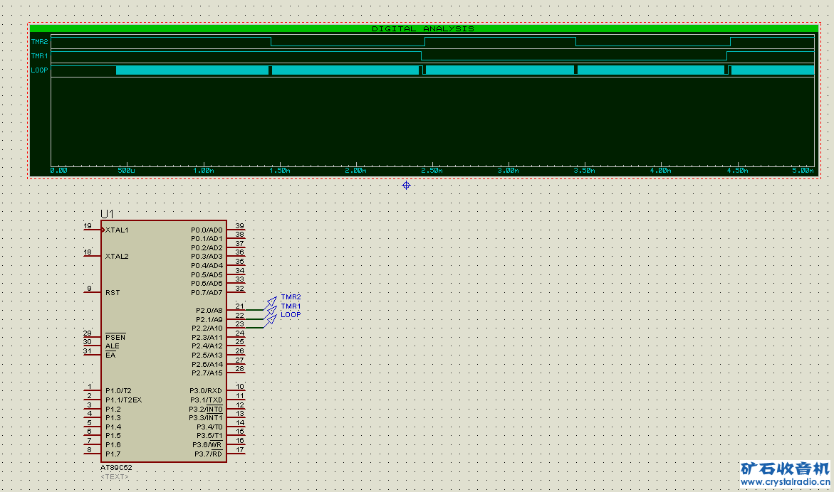

发表于 2011-5-1 05:11:02 | 显示全部楼层
here is an example showing what clearing TF2 in the isr does:
#include <regx52.h>                                        //at89c52
#include "gpio.h"
//hardware configuration
#define OUT_PORT                        P2
#define OUT_DDR                                P2
#define OUT_TMR2                        (1<<0)        //tmr2 indicator
#define OUT_TMR1                        (1<<1)        //tmr1 indictor
#define OUT_LOOP                        (1<<2)        //loop indicator
#define OUT_TMR0                        (1<<3)        //tmr0 indictor
#define PERIOD_TMR2                        (F_CPU / 1000 * 1)        //tmr2 period = 1ms
#define PERIOD_TMR1                        (F_CPU / 1000 * 2)        //tmr1 period = 10ms
#define PERIOD_TMR0                        (F_CPU / 1000 * 4)        //tmr1 period = 10ms
//end hardware configuration
#define MSB(val)                        ((val) >> 8)        //most significant byte
#define LSB(val)                        ((val) & 0x00ff)        //least significant byte
//tmr2 isr
void tmr2_isr(void) interrupt TF2_VECTOR {
        TF2=0;                                                        //clear tmr interrupt flag
        TH2+=MSB(-PERIOD_TMR2);                        //load up the tmr offset
        TL2+=LSB(-PERIOD_TMR2);
        IO_FLP(OUT_PORT, OUT_TMR2);                        //flip the output pin
//initialize tmr2
void tmr2_init(void) {
        TR2=0;                                                        //turn off the timer
        C_T2=0;                                                        //tmr2 as a 16bit tmr
        RCAP2H=0;                                                //do NOT use the auto reload function
        RCAP2L=0;
        TH2=MSB(-PERIOD_TMR2);                        //load up the tmr offset
        TL2=LSB(-PERIOD_TMR2);
        ET2=1;                                                        //turn on tmr2 interrupt
        TR2=1;                                                        //turn on tmr2
//tmr1 isr
void tmr1_isr(void) interrupt TF1_VECTOR {
        TF1=0;                                                        //clear tmr interrupt flag
        TH1+=MSB(-PERIOD_TMR1);                        //load up the tmr offset
        TL1+=LSB(-PERIOD_TMR1);
        IO_FLP(OUT_PORT, OUT_TMR1);                        //flip the output pin
//initialize tmr1
void tmr1_init(void) {
        TR1=0;                                                        //turn off tmr1
        TMOD = (TMOD & 0x0f) | 0x10;        //tmr1 running in mode 1: 16-bit timer, not gated
        TH1=MSB(-PERIOD_TMR1);                        //load the offset
        TL1=LSB(-PERIOD_TMR1);
        ET1=1;                                                        //turn on tmr1 interrupt
        TR1=1;                                                        //turn on tmr1
//tmr1 isr
void tmr0_isr(void) interrupt TF0_VECTOR {
        TF0=0;                                                        //clear tmr interrupt flag
        TH0+=MSB(-PERIOD_TMR0);                        //load up the tmr offset
        TL0+=LSB(-PERIOD_TMR0);
        IO_FLP(OUT_PORT, OUT_TMR0);                        //flip the output pin
//initialize tmr1
void tmr0_init(void) {
        TR0=0;                                                        //turn off tmr1
        TMOD = (TMOD & 0xf0) | 0x01;        //tmr1 running in mode 1: 16-bit timer, not gated
        TH0=MSB(-PERIOD_TMR0);                        //load the offset
        TL0=LSB(-PERIOD_TMR0);
        ET0=1;                                                        //turn on tmr1 interrupt
        TR0=1;                                                        //turn on tmr1
void mcu_init(void) {
int main(void) {
        mcu_init();                                                //reset the mcu
        tmr1_init();                                        //initialize tmr1
        tmr2_init();                                        //initialize tmr2
        ei();                                                        //enable global interrupt
        while (1) {
                IO_FLP(OUT_PORT, OUT_LOOP);        //flip out_loop
the code runs on at89c52 and contains the set-up and isr pieces for tmr0, tmr1 and tmr2. in this particular example, I only set up tmr1 and tmr2. and for tmr2, to disabled the auto reloading and opt to use manual reloading.
As a result, tmr1 and tmr2's initialization and isr are almost identical: basically, we clear the flags, reload the counters, and flip their respective output pins and life goes on.
we set so that tmr2 flips its pins every 1ms and tmr1 every 2ms.
and simulation shows that.
发表于 2011-5-1 05:15:00 | 显示全部楼层
notice that in tmr2_isr(), we cleared TF2 once we are in the isr?
now, we are going to comment out that sentence and here is what you get in simulation:
发表于 2011-5-1 05:17:46 | 显示全部楼层
you will see that OUT_TMR2 is flipping at much higher frequency (about 20Khz), vs. 500hz before. Because now, TF2 is not cleared. As a result, the mcu spends the bulk of its time servicing tmr2_isr() - in fact, the mcu serves just one instruction in the main while() loop for each time it takes to service tmr2_isr().
that's why OUT_LOOP is also flipping at much lower frequencies too.
发表于 2011-5-1 05:19:08 | 显示全部楼层
you can do similar things to the TF0 and TF1 flags in the tmr0_isr() and tmr1_isr() routines and you will NOT see the same result, because until TF2, TF1 and TF0 are automatically cleared when their respective isrs are serviced.

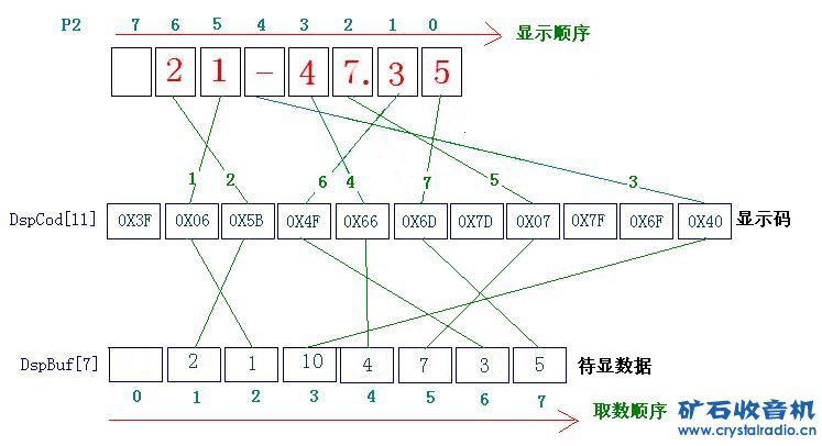

数组的应用
数组
程序中数组是是非有用的,所谓数组,就是在内存中一块连续的存储单元,数据存在于这些单元中。和变量一样,要使用数组,首先得声明,建立一个数组,例如:
unsigned char Disp[];
就声明了一个数组,它的名称是Disp,它的类型是无符号字符型,大的大小:存储单元的多少没说,但是每个单元只能存进无符号字符数,也就是每个单元只能存放1个字节的数据;如果
unsigned char Dsp1[11];
则声明了另一个无符号字符型数组,Dsp1,它具有11个存储单元也称为“元素”,这些元素分别编号为
0,1,2,3,4,5,6,7,8,9,10.这些编号称为数组元素的“下标”那么在声明了这个数组以后,就可以给它的各个元素存入数据:例如
Dsp1[0]=0x25;
Dsp1[10]=9;
要注意现在是给他的0号元素和10号元素赋值,它的元素下标最大就是10:从0到10共有11个元素!
还可以在声明数组时就一次性给它的各个元素赋初值,例如:

在数字钟程序里数组的使用:
为了在8个数码管上显示时间数据,最开始已经说过,是把待显示的某位数码管字段码送到P0口,然后打开该
位的控制线,显示这一位。然后P0口加上下一个字段码,打开下一位控制线。而显示的时分秒数据是变化的。
这样我们先建立一个具有8个单元-对应于8个数码管;显示缓存数组:
unsigned char DspBuff[8];它的各个单元存数是
DspBuff[0]=空白;
DspBuff[1]=时十位;
DspBuff[2]=时个位;
DspBuff[3]=负号;
DspBuff[4]=分十位;
DspBuff[5]=分个位;
DspBuff[6]=秒十位;
DspBuff[7]=秒个位;
现在要显示这些数字、符号,还得把它们转换为对应的字段码;为此我们建立一个显示码数组
unsigned char DspCode[11]={0x3f,0x06,0x5b,0x4f,0x66,0x6d,0x7d,0x07,0x7f,0x6f,0x40};从0号到9号元素存放的是0到9的数码管显示字段码,最后一个是负号的字段码,那么要显示就按照数码管位置逐个取出
DspBuff的数据,以这个数据为数组下标去查找DspCodeai在这个下标元素的数据:相应的显示码。如下图所示。
