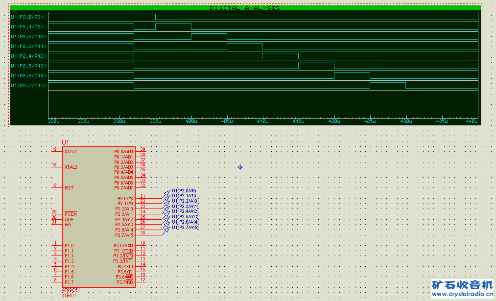

发表于 2011-4-28 23:44:44 | 显示全部楼层
或许会说,干嘛这么麻烦非要用变量a给P2赋值,直接就
P2=0X01;
P2=P2<<1;
不行吗?虽然说这样做KEIL编译器也能通过,但实际上却达不到运行效果,LED不会点亮,对于P2(其他口也一样)可以进行位运算符操作:但是移位除外。这点要注意。
maybe because you didn't do it right?
here is the execution of the following code:
#include <regx51.h>
int main(void) {
        P2 = 1;
        while (1) {
                P2 = P2 << 1;
notice the changes in the pins on P2?
[ 本帖最后由 millwood 于 2011-4-29 01:06 编辑 ]
 楼主| 发表于 2011-4-29 11:31:25 | 显示全部楼层
你仿真是可以没错,我现在用的是keil硬件做出来的,最好你自己也去做一下,看看究竟行不行,P口不能进行移位操作不是我发明的,书上也是这么说的。仿真和实际还是有差距。你去用硬件做一个电路做一个再说吧

发表于 2011-4-29 13:05:02 | 显示全部楼层
简单啊!看看C语句编译成汇编是什么样子的就知道了
这段代码:
#include <regx51.h>
int main(void) {
        P2 = 1;
        while (1) {
                P2 = P2 << 1;
对应的汇编是:

发表于 2011-4-29 22:36:27 | 显示全部楼层
原帖由 wey05 于 2011-4-29 11:31 发表
我现在用的是keil硬件做出来的,
did you use "P2 <<=1;' and it didn't work on your hardware or you used "var <<= 1; P2=var;" and it did work?
many false things are said in many books too. that doesn't make them true.
发表于 2011-4-29 22:48:51 | 显示全部楼层
我这就有硬件,可以回来try下,而且还有本书 ,开头讲流水灯里面有这个,我也回来看下
you will find cases where such an approach ("P2 = P2 << 1;") may fail. what 8051 vendors licensed from Intel is the core and they have to design their own peripherals (like IO ports). on some 8051 chips, you do not have output latches on the IO ports. so when you turn to read that pin / port, you are actually reading the voltage on that port / pin and the load on that pin / port will force a "0' read on that port / pin. that's where this approach will fail.
most chips today have otuput latches.
a more interesting approach on a shadow variable is to use a sequence:
#define SEQ1(val) (((val) << 1) | ((val) & 0x80)?1:0)
#define SEQ2(val) (((val) << 1) | ((val) & 0x80)?0:1)
  while (1) {
    s=SEQ1(s); //get a new pattern (seq1)
    OUT_PORT = s; //output the new pattern
try to use SEQ1() and SEQ2() and see how the leds behave.

 楼主| 发表于 2011-4-30 15:27:52 | 显示全部楼层
原帖由 millwood 于 2011-4-29 22:36 发表
did you use "P2
哈哈英文老兄又来了,看好了,我,说,
unsigned char ve=0x80;
P2=ve;
ve>>=1;
P2=ve;
当然没问题!只是
P2=0X80;
P2>>=1;
keil编译没问题,可以通过,实际运行不行,我的硬件有问题吗见本帖开始的图,书说的不对?编书的不至于糊涂至此吧。还是请你深入分析一下问题在什么地方
[ 本帖最后由 wey05 于 2011-4-30 16:03 编辑 ]
