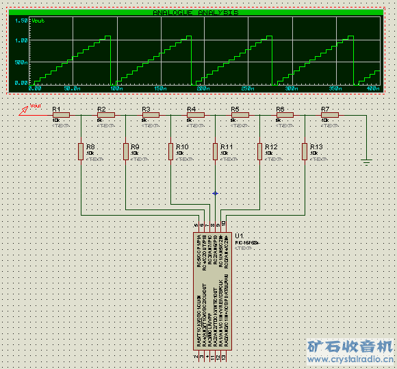

it would be fairly easy to do something like this with a mcu.
four bits will get you 16 levels.
[ 本帖最后由 millwood 于 2010-4-5 09:35 编辑 ]
