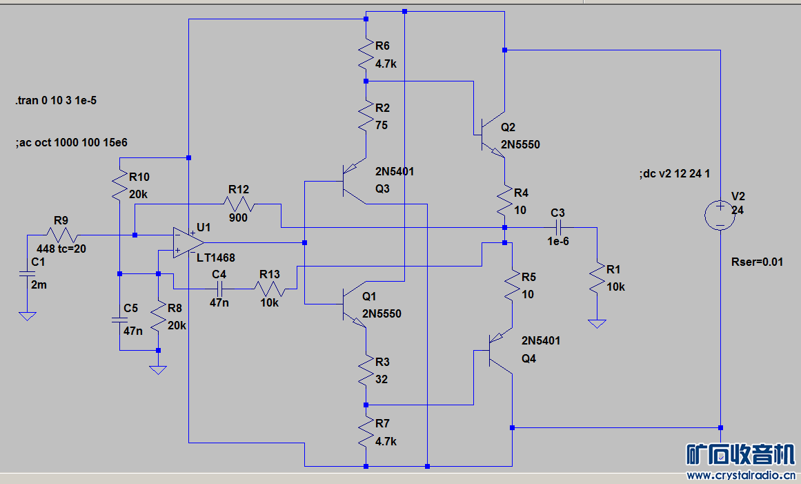

电灯泡稳幅的 1KHZ 文氏振荡电路

 楼主| 发表于 2013-7-21 14:44:10 | 显示全部楼层
tlxli 发表于 2013-7-20 17:46
我也試試看!
附上原理图。

 楼主| 发表于 2013-7-26 14:26:40 | 显示全部楼层
millwood 发表于 2013-7-25 12:28
How about Christmas lights?
or Radioshack? They have some 1.5v / 12v miniature lamps, like th ...
    Chrismas lights are 80~90 ohms at full power (4V something),
    to get good THD,  output should be kept below 10Vp-p.
    you can expect  5 / 1.4142 / 3 = 3.536 /3 = 1.179 Vrms on the lamp.
   When there's only 1.2Vrms accross a Chrismas light,  it's resistance will be is only 20~30 ohms.
   The Rf between output and inv-input will be roughly 100 ohms or less.
    Opamps with low output current can't yield good THD with such a heavy load.
     With the help from this article:
http://www.moorepage.net/Lamps.html
http://www.crystalradio.cn/thread-401781-1-1.html
     I  figured out  a good light bulb has to be a bulb with about 300ohm cold resistance.
    120V4W,  48V1W  happened to fit into that range.
   this one you posted should be quite good:
http://www.radioshack.com/product/index.jsp?productId=2103780
     but I couldn't find it in Vancouver.    I tried Home Depot, tough luck.
  in this sch, R9 is the lamp,  48V1W.
  it oscillates at about 300Hz,  with a very cheap TL081,  THD is well below -90dB.  I tested it with a Keithley 2015.

发表于 2013-7-27 04:33:45 | 显示全部楼层
做灯泡稳定幅度的振荡器,使用分立元件更合适些,使用运放的话,要用很高级的运放,一个运放的价格一般人估计有些受不了。3DJ6  或DJ7 /SK30做差分输入,后续简单给上2级三极管+输出级,区区6,7个管子
性能要比使用运放的好的,用12伏特的仪表灯泡做过一个,还可以扫频,稳幅性能确实不错。额
要想性能理想必须给灯泡提供一定量的发热电能,说白了也就是要有足够大的电流流过灯泡来靠温度升降来改变它本身的电阻,这个要是用运放做到反馈回路  ,呵呵 ,这个运放的价格嘛。。。。。。。
使用分立的元件一般是要有功率输出级来反馈给前面场效应管电压,消耗一定的功率。灯泡倒是无所谓,想省电点,也就是把功率放大级那里负担降下来的话,就用灯丝细的,如果功率足够的话,随便弄个12V6A的汽车灯泡也是可以的。
其实 使用线性的正温度系数热敏电阻 效果是一样的,很多信号源用的就是这个,不用灯泡啦 ,怎么说,灯泡灯丝抗震性能不好,然后呢,幅度就不稳定啦。   但不要拿那个软件仿真来扯。哪一款仿真也不会给你仿真,信号源使用的时候,你突然往信号源上面放了一个茶杯或者说用手推了一把信号源,就这一下下呀,那个多少多少稳定度的XX信号啊,就突然变的很离谱啦。。。。。
