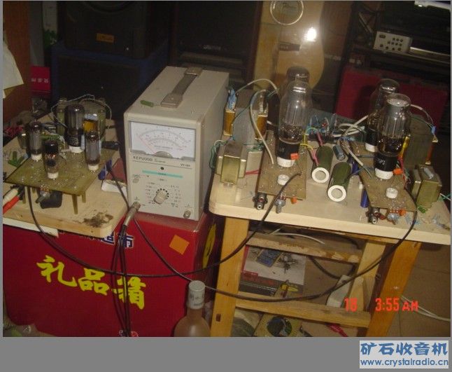

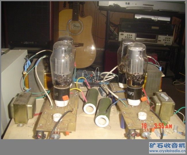

6n5pp并联单端
6n5pp并联单端
6n5pp并联单端
6n5pp并联单端
[我也在实验中,此电路已试听一年多,目前状况良好,电路都是共阴极放大器,B+230v,6n5p阴极电压65v电压,6p14三极管接法做后级推动
