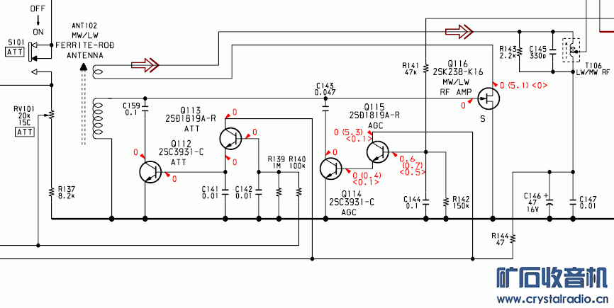

LW/MW天线回路:磁棒天线,不调谐
LW/MW高放:2SK238-K16 JFET共源放大器,漏极负载为低Q LC回路,不调谐。
LW/MW输入衰减:2SC3931-C,衰减进入高放栅极的信号
LW/MW高放AGC:2SC3931-C,衰减进入高放栅极的信号

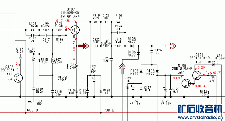

SW天线回路:LC带通滤波,不分波段,不调谐
SW高放:2SK508-K51 JFET源极跟随器,源极负载为8.2uH电感+100Ω电阻,LC低通滤波输出
SW输入衰减:2SC3931-C,衰减进入高放栅极的信号
SW高放AGC:MA77 x2,衰减源极输出的信号
LW/MW/SW至一混频的波段开关:MA77 x2

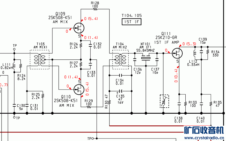

一混频:2SK508-K51 x2,双JFET平衡混频器,宽带变压器输入/输出,一本振由源极注入
一中频滤波:55.845MHz晶体滤波器
一中放:2SK210-GR JFET共源放大器,LC谐振回路负载

一中频滤波:两组55.845MHz晶体滤波器串接
一中放:3SK132A-T1U36双栅放大器,LR负载

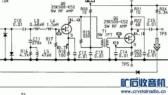

SW本机天线回路:不调谐
SW高放(仅用于本机天线,外接天线时越过SW高放,直接进下面的6个SW波段带通滤波器):一高放2SK508-K52  JFET共源极放大器,宽带变压器负载;二高放2SK508-K52共源极放大器,电阻负载。均无AGC
SW带通滤波器:分SW1-6,LC
LW/MW/SW波段切换:1SS279
一混频前置放大器:2SK508-K52 JFET共源放大器,电阻负载。SW55怎么这么多级高频放大?增益不会太高吗?

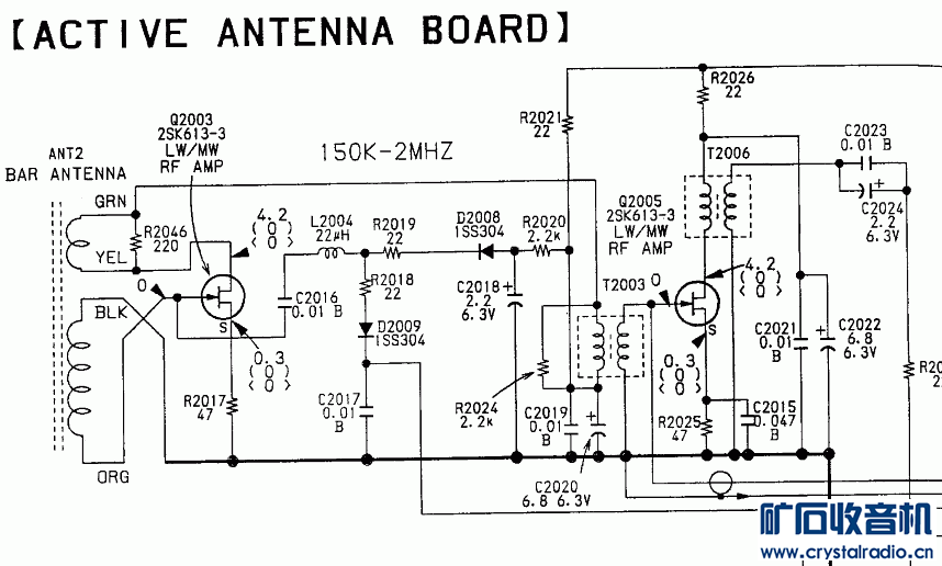

天线放大器板:
LW/MW天线回路:公用磁棒及线圈
LW/MW天线一高放:2SK613-3 JFET共源放大器,宽带变压器负载
LW/MW天线一高放AGC:1SS304 x2,衰减一高放栅极输入信号
LW/MW天线二高放:2SK613-3 JFET共源放大器,宽带变压器输出

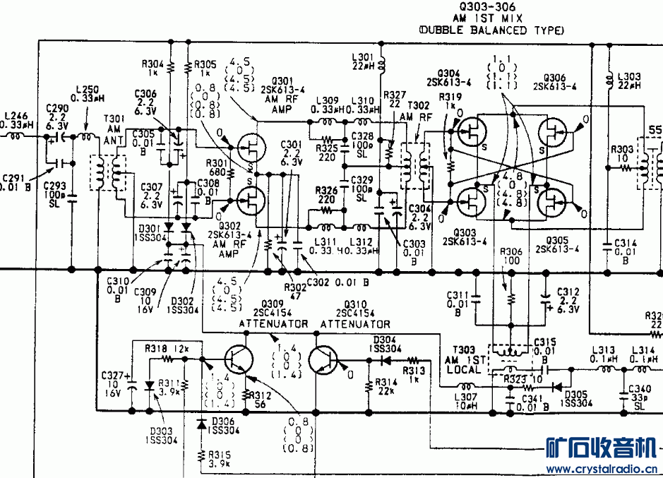

高放:2SK613-4 x2,双JFET共源推挽放大器,宽带变压器输入,LC谐振变压器输出(不调谐)
高放AGC:1SS304 x2,衰减进入高放栅极的信号
一混频:2SK613-4 x4, 4 JFET双平衡环形混频,一本振由源极注入,混频输入、混频输出、本振输入均为带中间抽头的宽带变压器

I am surprised by two things:
1) the extensive use of a "regen" type rf preamp. I don't think it is to enhance gain (by introducing positive feedback), and I don't think it is to widen the bandwidth (by introducing negative feedback) either as those transistors have fairly wide ft to begin with.
2) the primitive nature of the agc: wow!
