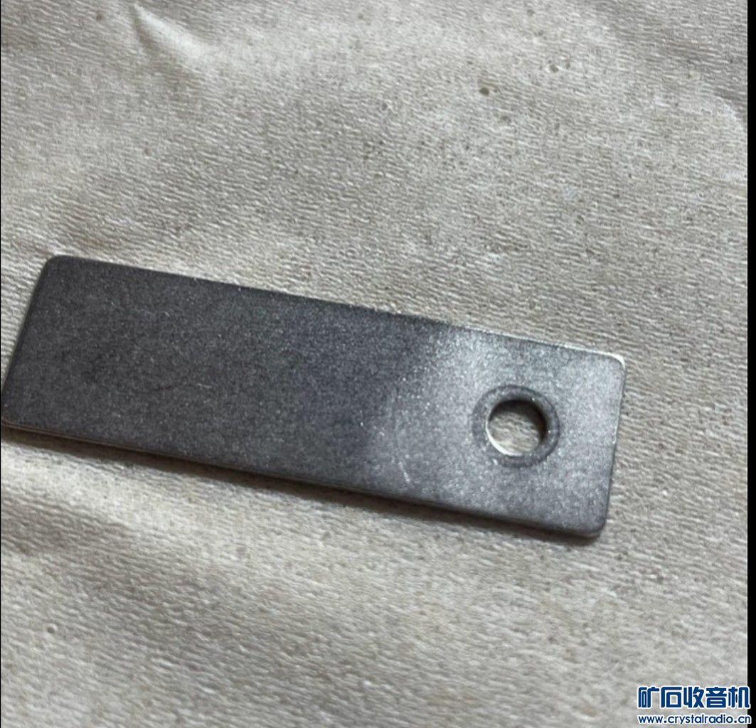

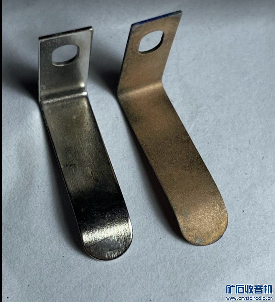

 楼主| 发表于 2024-1-16 11:16:56 | 显示全部楼层
Yesterday , im disassembly MF10 , clean Battery leakage in battery holder. But process stop when i want to take out PCB . Screw nut very tight , and i dont have tools for take apart . Today need buy one curved pliers and try again .
Anyone know how to take  apart of MF10 ?
