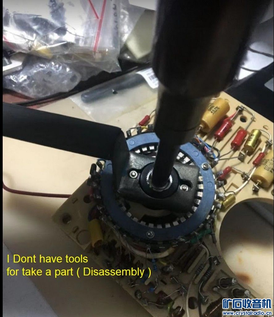

Yesterday , im disassembly MF10 , clean Battery leakage in battery holder. But process stop when i w ...

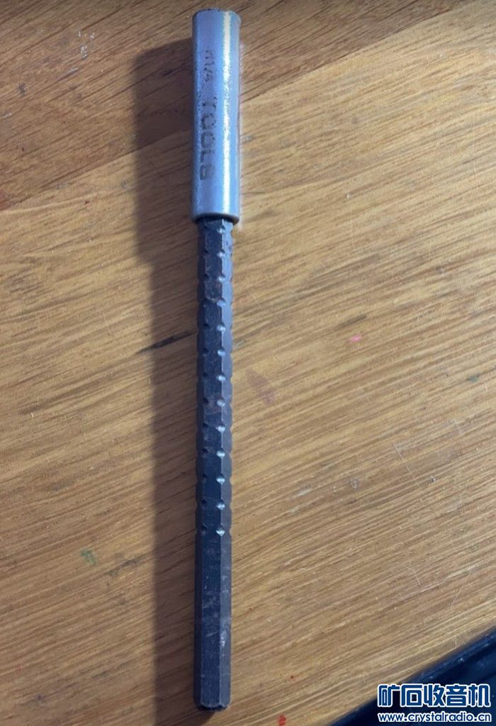

MF10的转盘开关不好拆,这种弯嘴钳也可以,但我觉得咸鱼上的那个工具会很好用。
 楼主| 发表于 2024-1-16 12:23:27 | 显示全部楼层

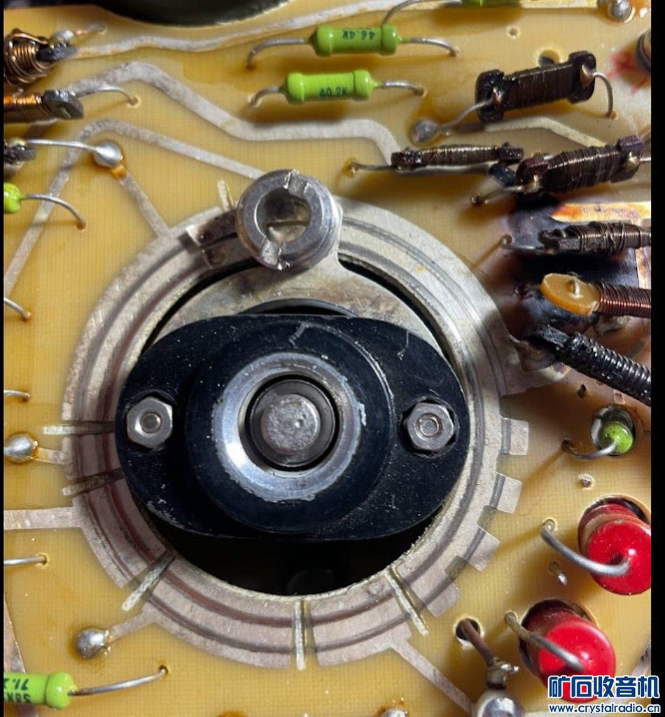

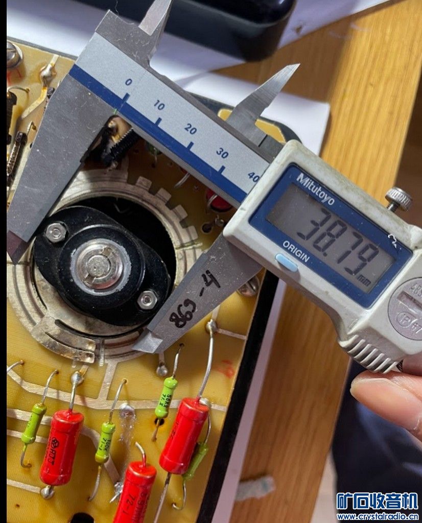

Need take time to buy tools for take apart screw ( 2-3 week ) . But i have one question , Screw its  right-hand screw
or left-handed screw ?
发表于 2024-1-16 12:44:30 | 显示全部楼层
chihaxinh 发表于 2024-1-16 12:23
Need take time to buy tools for take apart screw ( 2-3 week ) . But i have one question , Screw it ...
逆时针旋转是松开。

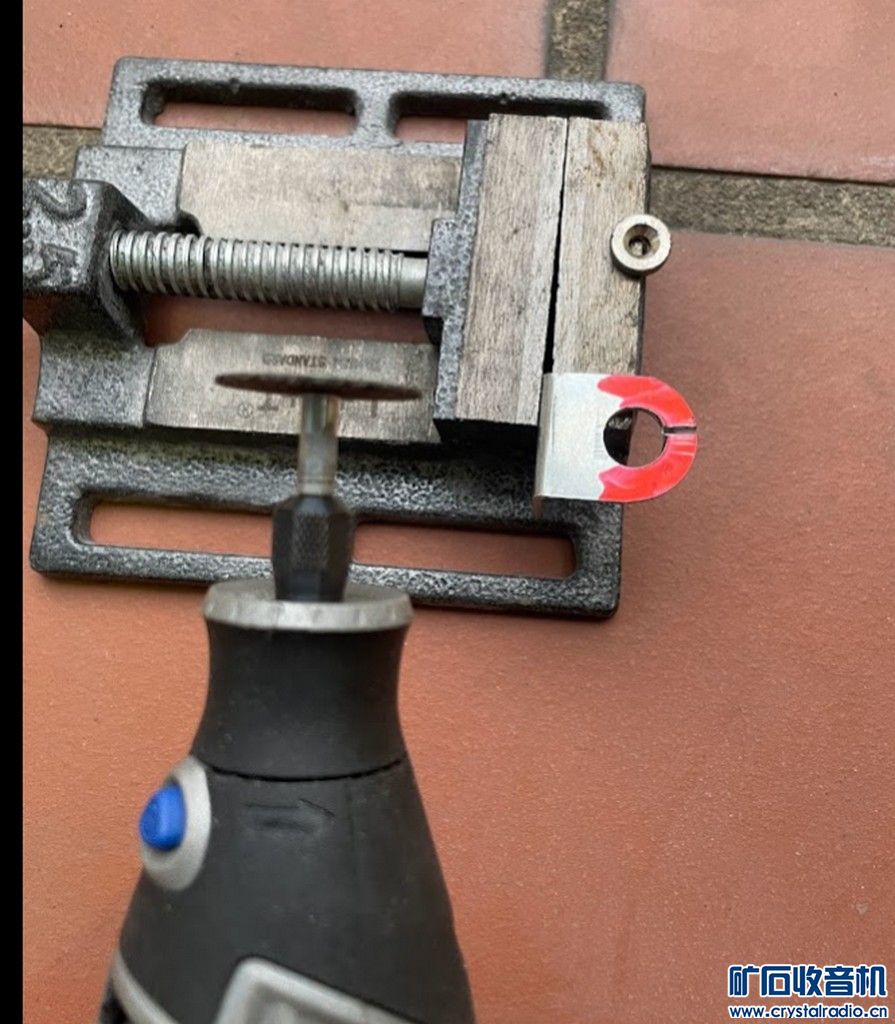

 楼主| 发表于 2024-1-16 20:26:45 | 显示全部楼层

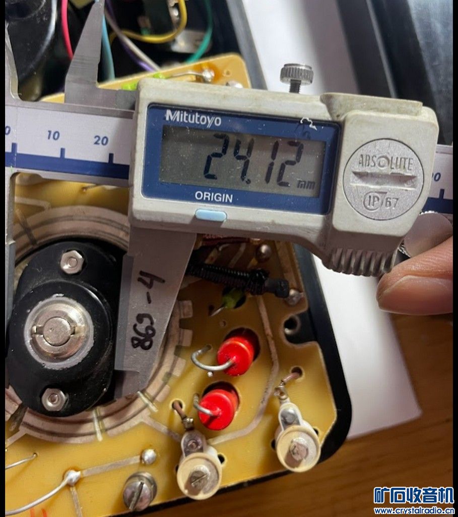

Although i buy tools for take apart PCB out to make clean and modifier. But it's take long time so i diy one a piece hard steel . So , its work !
But i need take apart item i note in Picture. Very Tight , anyone know how to dissassembly part ?
发表于 2024-1-16 20:43:26 | 显示全部楼层
MF10的转盘开关不貌穑庵滞渥烨部梢裕揖醯孟逃闵系哪歉龉ぞ呋岷芎糜谩
闲鱼上的啥工具?有图片没?
发表于 2024-1-16 21:03:12 | 显示全部楼层
syb888 发表于 2024-1-16 20:43
闲鱼上的啥工具?有图片没?
楼主发的这个就是。
发表于 2024-1-16 21:17:02 | 显示全部楼层
老郑小烧 发表于 2024-1-16 21:03
楼主发的这个就是。
我在闲鱼没找到,您有这方面的线索吗?关键词或者商家?
发表于 2024-1-16 21:17:24 | 显示全部楼层
chihaxinh 发表于 2024-1-16 20:26
Although i buy tools for take apart PCB out to make clean and modifier. But it's take long time so i ...
我找到了2个配件,但实际上我并没有拆过它。从结构看,在轴承和轴之间应该有个“卡簧”。
私信给你了,这套工具是拆第一层螺丝的。
发表于 2024-1-16 21:24:40 | 显示全部楼层
你临时做的这个工具非常好!
发表于 2024-1-16 21:44:22 | 显示全部楼层
如果无从下手,我猜测可以从表的正面那端,用力敲击就可以把轴顶出来——只是猜测。

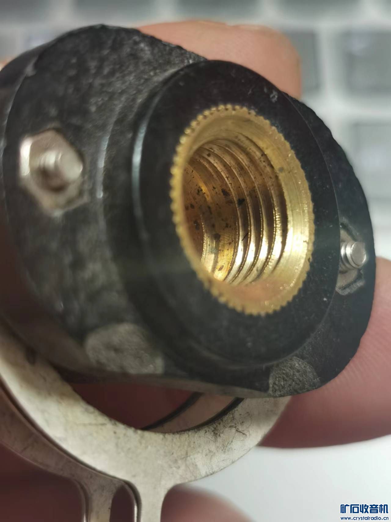

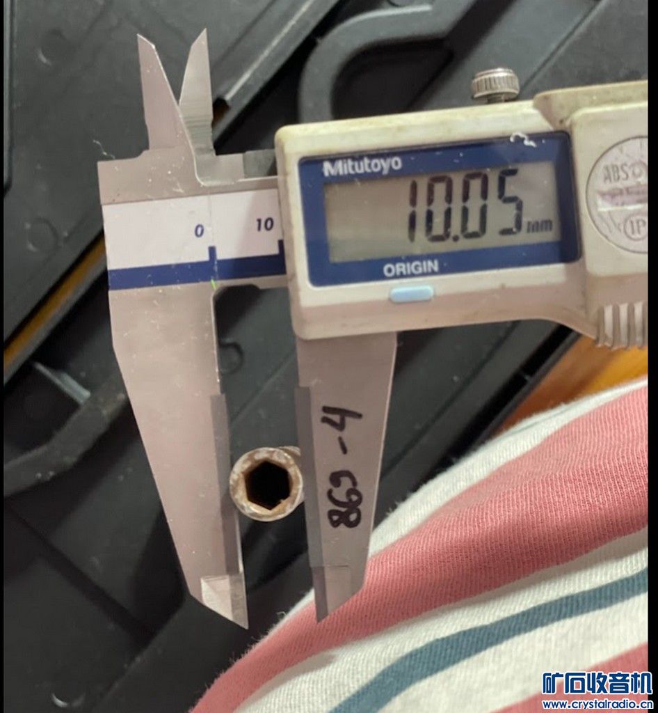

 楼主| 发表于 2024-1-16 22:11:13 | 显示全部楼层
老郑小烧 发表于 2024-1-16 21:19
私信给你了,这套工具是拆第一层螺丝的。

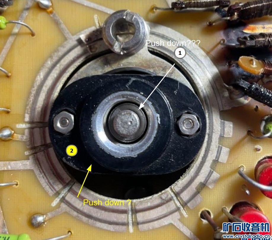

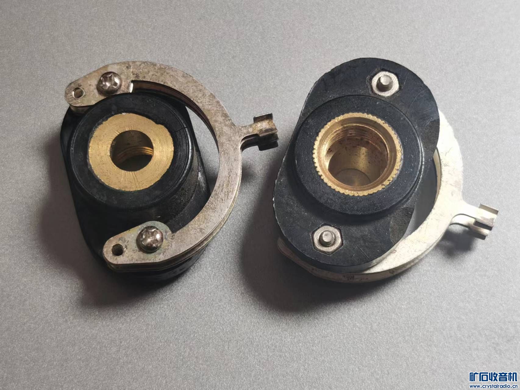

It's call "望梅止渴" , if waiting 2 week when turn down felling. it's time 滿腔熱情 . Steel piece it's 铰链  buy in store with price 1 ¥
One friend in 闲鱼 give me 2 picture and said . Selector of MF10 have 2 nuts . and need "push down" for release tight . And can take apart item.
But i really dont understand "push down" what ? 1 or 2 in picture ?
发表于 2024-1-16 22:19:10 | 显示全部楼层
chihaxinh 发表于 2024-1-16 22:11
It's call "望梅止渴" , if waiting 2 week when turn down felling. it's time 滿腔熱情 . Steel piece  ...
我想应该是 3,主轴,按照我画的方向,从照片看是 pull,不是 push。
 楼主| 发表于 2024-1-16 22:37:52 来自手机 | 显示全部楼层

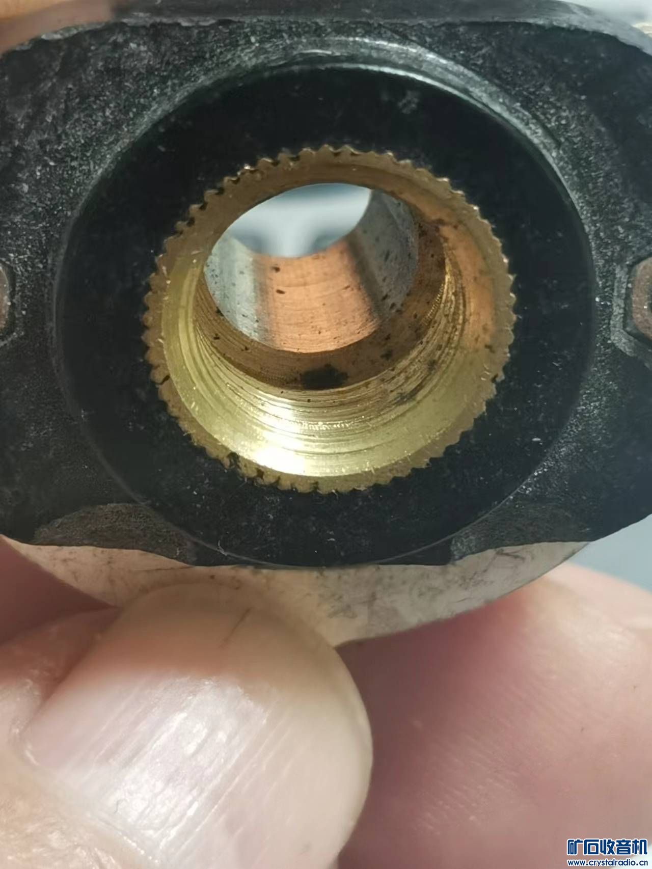

Its my friens said "
这个丝扣的方向是正常的,逆时针旋转就能解决
拧出这个螺丝后,里面还有一个楔形环
向下压一下,解除楔形环的应力后,才能卸下"
I take apart PCB and go to clean burn out are and clean pcb pad !
