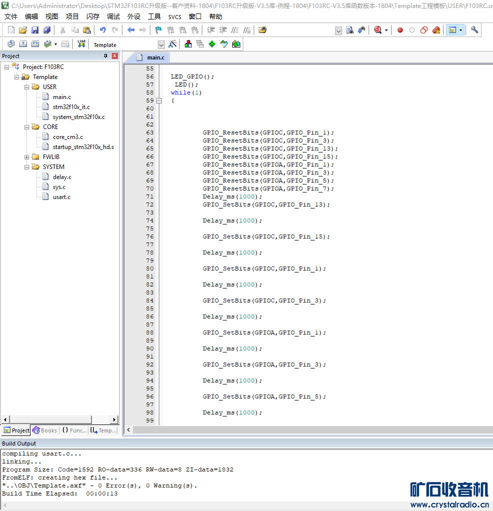

研究STM32几天终于可以控制IO口了
发表于 2020-1-1 19:59:10 | 显示全部楼层 |阅读模式
实现了流水灯
#include "stm32f10x.h" //头文件
void LED(void)             //PA口初始化
     GPIO_InitTypeDef GPIO_InitStructure;
     RCC_APB2PeriphClockCmd(RCC_APB2Periph_GPIOA,ENABLE);
     GPIO_InitStructure.GPIO_Pin = GPIO_Pin_1 | GPIO_Pin_3 | GPIO_Pin_5| GPIO_Pin_7 ;
     GPIO_InitStructure.GPIO_Mode = GPIO_Mode_Out_PP;
     GPIO_InitStructure.GPIO_Speed = GPIO_Speed_50MHz;
     GPIO_Init(GPIOA, &GPIO_InitStructure);
void LED_GPIO(void)         //PC口初始化
     RCC_APB2PeriphClockCmd(RCC_APB2Periph_GPIOC,ENABLE);
     GPIO_InitStructure.GPIO_Pin = GPIO_Pin_13 | GPIO_Pin_15 | GPIO_Pin_1| GPIO_Pin_3 ;
     GPIO_Init(GPIOC, &GPIO_InitStructure);
void Delay_ms(uint16_t time)  //延时函数
    u16 i=0;
    while(time--)
        i=10000;
        while(i--) ;
int main()
        LED_GPIO();   //初始化PC口
         LED();           //初始化PA口
        while(1)
                                  GPIO_ResetBits(GPIOC,GPIO_Pin_1);              //关闭PC1
                                  GPIO_ResetBits(GPIOC,GPIO_Pin_3);             //关闭PC3
                                  GPIO_ResetBits(GPIOC,GPIO_Pin_13);
                                  GPIO_ResetBits(GPIOC,GPIO_Pin_15);
                                  GPIO_ResetBits(GPIOA,GPIO_Pin_1);
                                  GPIO_ResetBits(GPIOA,GPIO_Pin_3);
                                  GPIO_ResetBits(GPIOA,GPIO_Pin_5);
                                  GPIO_ResetBits(GPIOA,GPIO_Pin_7);
                                  Delay_ms(1000);
                                  GPIO_SetBits(GPIOC,GPIO_Pin_13);         //点亮PC13
                                  Delay_ms(1000);                                     //延时
                                  GPIO_SetBits(GPIOC,GPIO_Pin_15);          //点亮PC15
                                  Delay_ms(1000);
                                  GPIO_SetBits(GPIOC,GPIO_Pin_1);            //点亮PC1
                                  Delay_ms(1000);
                                  GPIO_SetBits(GPIOC,GPIO_Pin_3);           //点亮PC3
                                  Delay_ms(1000);
                                 GPIO_SetBits(GPIOA,GPIO_Pin_1);             //点亮PA1
                                 Delay_ms(1000);
                                 GPIO_SetBits(GPIOA,GPIO_Pin_3);
                                 Delay_ms(1000);
                                GPIO_SetBits(GPIOA,GPIO_Pin_5);
                                Delay_ms(1000);
                                GPIO_SetBits(GPIOA,GPIO_Pin_7);
                                Delay_ms(1000);
