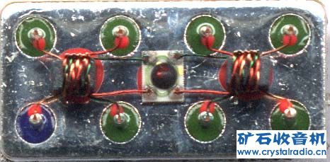

发表于 2011-3-31 09:23:00 |
here is a picture of a double-balanced mixer (dbm), ade-1, by mini-circuits.
does it look like 对二极管参数和变压器的绕制参数要求很苛刻,二极管需严格配对,变压器要高度对称?
as a passive mixer, a DBM has very wide input signal range, is simple and flexible. However, it is bulky (vs. ic mixers), more expensive (vs. ic mixers) as the manufacturing process is highly manual.
but it is probably an ideal mixer to diy.
发表于 2011-3-31 09:25:57 |
ade-1 is good from DC to 500Mhz, in case you want to know.
here is the inside of SBL-1, probably the most famous level-7 DBM ever produced.
doesn't look that "二极管需严格配对,变压器要高度对称" to me.
