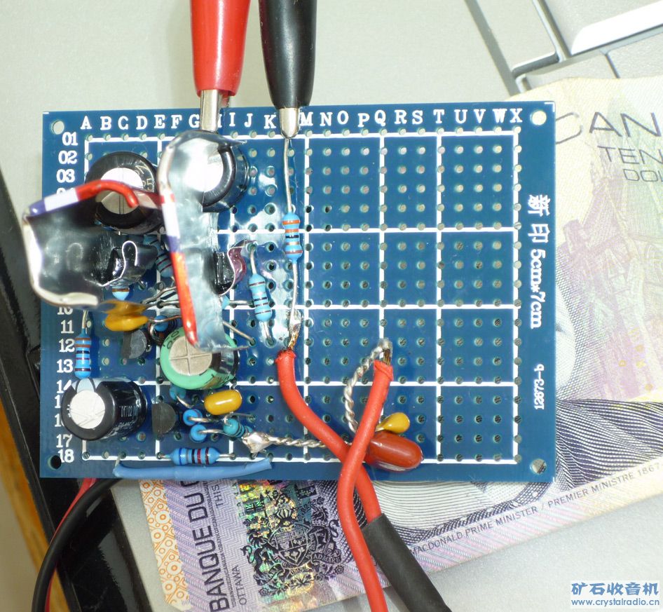

 楼主| 发表于 2010-8-16 03:39:34 | 显示全部楼层
实物照片
今晚上抽了 1 小时做的原型,  散热片用废的 9V 叠层电池的外皮做的.  实际制作中连调试都不用,  焊好就出声了, 这就是仿真的目的.
最下面是波型,  波型黄色是输出, 另一个是输入.

发表于 2010-8-16 07:23:01 | 显示全部楼层
nicely done.
a couple suggestions:
1) the spot I circled in red looks to be dangerously close. you may want to add some insulation there.
2) the area I circled in green looks like some kind of goo where the heat sink is, you may not want to cover the heat sink with the goo. that doesn't promote ventilation.
otherwise, build the other channel and you get yourself a high quality headphone amp!
 楼主| 发表于 2010-8-16 11:10:02 | 显示全部楼层
原帖由 millwood 于 2010-8-16 07:23 发表
nicely done.
2) the area I circled in green looks like some kind o ...
thanks, man!
this is the 1st test to verify that the 2sc1815/2sa1015 could survive.
I'm using another larger board to build a stereo one.
A finding:
It seems that this circuitry is prone to oscillate after hooking up the headphone.
So I put a 10pF cap parallel to the 900 ohm resistor to lower it's slew rate to eliminate the trend. Is it a right means?
