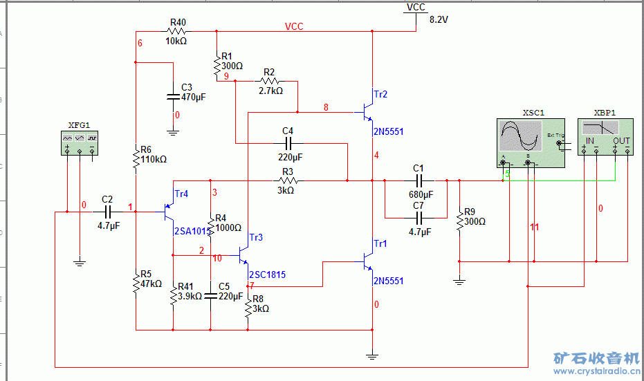

发表于 2010-8-12 01:08:20 | 显示全部楼层 |阅读模式
感谢 millwood 让吾知道了这个好玩的电路.
http://www.tcaas.btinternet.co.uk/jlhnotes.htm
http://www.tcaas.btinternet.co.uk/index-1.htm
根据计算,  这个电路输入 100mV时 能让 Sennheiser HD650 在您耳朵上输出 92 dB的声压,
并且这时的理论THD < 0.01.
同时保证很平坦的频率响应(20Hz~200KHz)和比较高的转换速率(>15V/us)
最终成本如果不算电池, 应该不超过 10 元人民币.
图在下面

发表于 2010-8-12 06:56:13 | 显示全部楼层
I am glad that you liked it.
a few suggestions:
1) the gain is about 4x. a little bit too high if you are interfacing it with a typical consumer electronics gear. their typical output is 1.5 - 2vp.
2) I would put a 1k resistor in serial with C2, as a simple means to condition the input signal.
3) I would also put a RE resistor on the output transistors. <11ohm should work. this enhances thermal stability.
4) since it is a headphone amp for high Z cans, I w ould also put a serial resistor on the output. 47ohm - 120ohm will do.

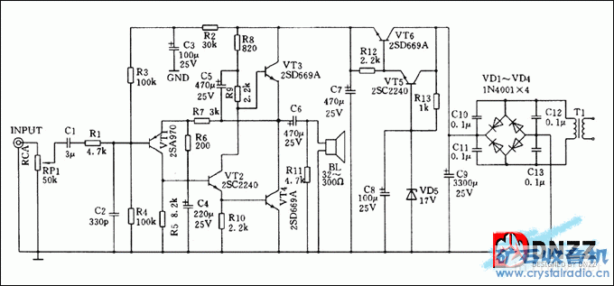

发表于 2010-8-12 08:39:18 | 显示全部楼层
这个不就是1969电路?
[ 本帖最后由 夏某 于 2010-8-12 08:41 编辑 ]
 楼主| 发表于 2010-8-12 15:42:40 | 显示全部楼层
原帖由 millwood 于 2010-8-12 06:56 发表
a few suggestions:
1.   setting gain to 3~4X is to alleviate signal source's load, hopefully it serves the purpose;
2.  I'd add it to see the difference;
3. Adding Re worsens the THD, but I'll add it to see the difference;
4. I'd add it for sure, also I'd put a 2k ohm resistor parallel to the output to eliminate  pops.
Thanks for your input!

原帖由 夏某 于 2010-8-12 08:39 发表
这个不就是1969电路?
JLH 1969,   是的

发表于 2010-8-14 05:28:22 | 显示全部楼层
a few more suggestions for you:
1) you can eliminate R8.
2) I try to splite R1/R2. typically making one of them as a pot.
3) you can rearrange R5/R6/R40, and replace with a pot + resistor. This helps define input impedance.
4) try to use lower value R3/R4 without sacrificing the amp's frequency response: this is a current feedback amplifier so you should use as low value R3/R4 as you can.
hope it helps.
发表于 2010-8-14 05:29:22 | 显示全部楼层
yes, because higher Re lowers open loop gain, thus lowers feedback -> lower TIM.
