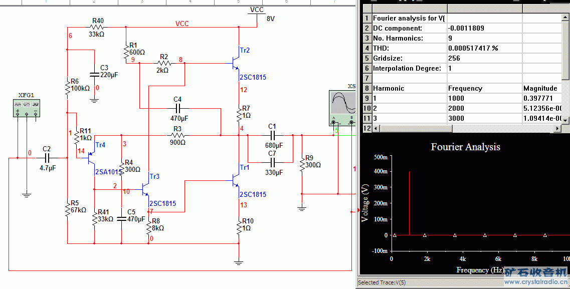

 楼主| 发表于 2010-8-14 15:18:55 | 显示全部楼层
原帖由 millwood 于 2010-8-14 05:28 发表
a few more suggestions for you:
1) you can eliminate R8.
2) I try to splite R1/R2. typically making one of them as a pot.
3) you can rearrange R5/R6/R40, and replace with a pot + resistor. This h ...

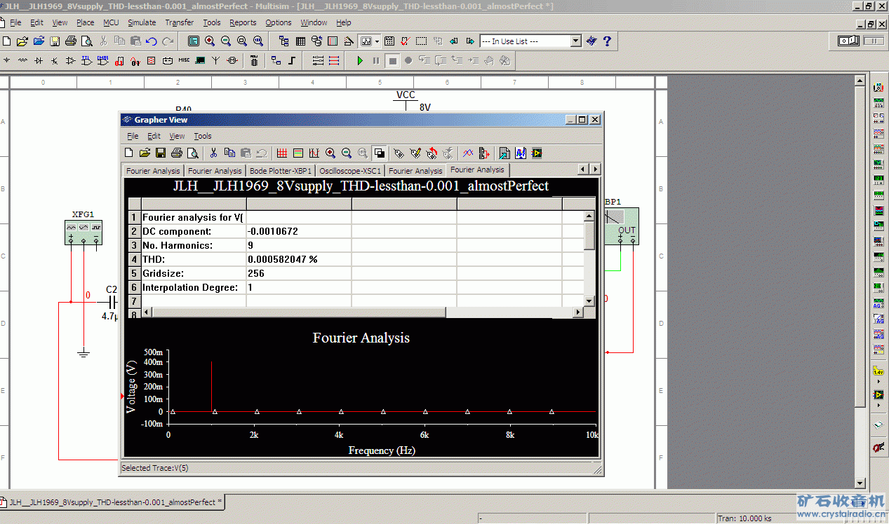

my primary concern is to lower the THD as much as possible,
IMHV,  this JLH's TIM is good enough for a layman like me.
Thanks,  millwood!  You are the lighthouse when I'm in the mist.
here's the latest result:
[ 本帖最后由 e3po 于 2010-8-14 15:32 编辑 ]

目前吾已经把电路的 THD 降低到 <0.0006 % 的理论值,   就算推 HD650 也不委屈它了.
毕竟 0.0006%  和 0.05%  已经相差了几乎两个数量级.

这也是 millwood 提示应该加两个 Re 的缘故,  提高温度稳定性.    加了以后用高 Hfe 的管子也不用太担心了.

e3po: you are too kind.
假设Tr1和Tr2的β相同,则Ic1=Ic2=β{(1/2Vcc-Ube1)/(R1+R2)-Ube1/R8},
you actually don't need to make that assumption: the circuit will change its output DC voltage to make sure that Ic1=Ic2.
发表于 2010-8-14 23:29:46 | 显示全部楼层
a small signal npn is a good choice for the amp if you are driving sensitive cans.
if you are dealing with low sensitive phones, you may want to go with a beefier transistor, like to126 or even to220 (to double as a power amp).

估计这是吾最后的优化了
成本更低,  因为 2sa1015/2sc1815 只要 1 毛钱一个
哈哈
[ 本帖最后由 e3po 于 2010-8-15 02:50 编辑 ]
发表于 2010-8-15 04:02:43 | 显示全部楼层
those are great audio transistors: beta flat to 30ma. wow!

 楼主| 发表于 2010-8-15 16:26:13 | 显示全部楼层
原帖由 millwood 于 2010-8-15 04:02 发表
        but I don't know whether either or them can dissipate 0.4 watt without heatsink, in worst case.
       I'm attaching a piece of copper sheet to each of the output stage to lower the thermal resistance. Hopefully this is a good approach.

at 8v Vcc, each device is taking on 4v. that means max DC Ic = 100ma.
and the 0.4w dissipation rating is likely obtained at 25c which isn't going to happen. so with a little bit of thermal derating, you are likely talking about much lower idle current - not a problem if you are using high sensitivity phones.
otherwise, go to a to126 device.

              Thanks, man!
               I'd give it a try 1st.  If bad thing happen then I'd swtich to 2sb649/2sd669 or 2sa1943/2sc5200.  :p
