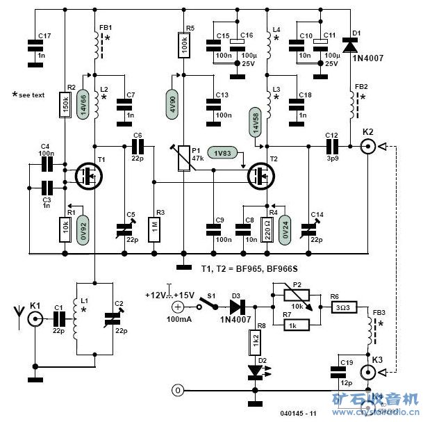

Together with a good directional antenna this high performance two-stage antenna amplifier for the VHF FM broadcast band will enable you to capture far removed (DX) stations. Alternatively, it will drastically improve reception of FM signals you’ve come to accept as marginal and noisy in your area.
For various reasons, an increasing number of people are not satisfied with the quality of radio signals that can be received via cable systems. Unfortunately, cross-modulation, and other nasty effects created in the head end station are in stark contrast with the superb quality of high-end FM tuners that can be bought commercially.
Not surprisingly, owners of such tuners will often prefer to have their own antenna on the roof. Add to that a high-performance FM antena booster like the one described here and you can start DXing as well as enjoying high-quality stereo reception. The author employs the present amplifier in combination with a Sangean ATS-803 World band receiver, a Philips RR-571 tuner and a single-element cubical quad directional antenna at a height of just 15 feet. Using this setup he is able to receive FM stations as far off as 500 km.
Antenna booster circuit description
In the design we’re about to describe you’ll find the following important parameters coupled: low noise figure (approx. 1 dB); high gain (up to 40 dB) and low susceptibility to intermodulation products. Yet the amplifier is inexpensive and easy to build. The circuit diagram in Figure 1 reveals the secret: dual-gate MOSFETs in positions T1 and T2. The first of these, T1, is configured mainly for low noise and antenna matching and the second, T2, for high gain. Unusually, the antenna signal is applied to T1 via its source (S) terminal, which is convenient because unlike one of the gates (G1 and G2) it already represents a fairly low impedance. None the less, for impedance matching with the 50 Ω coax cable a tap needs to be used on tuned filter L1/C2.
For VHF and UHF amplifiers, DG-MOSFETs represent a good alternative to cheap but noisy bipolar transistors and very expensive and difficult to get Ga-As FETs.
The gain of the second DG-MOSFET in the circuit is adjustable using preset P1 which varies the bias voltage to T2’s G2 terminal — this is the classic way of controlling the gain of a DGMOSFET and it still works very well. Such a control is included in the design to allow you to get the exact amount of gain required for your particular application. For example, if you live near a powerful VHF FM or TV broadcast transmitter then you’ll find that a lot of gain produces cross-modulation and other unwanted effects like coupled oscillation and ‘birdies’ within the FM band.
For stability the supply voltage is decoupled at several locations by electrolytic capacitors and ceramic capacitors for the low and high frequencies respectively. To enable it to be mounted as close as possible to the antenna, the amplifier is powered via the download coax cable, i.e., over coax connectors connected to K2 and K3. In the supply, the RF signal is taken off the coax core by capacitor C19.
The supply voltage is adjustable to some extent with pot P2, which will also allow a degree of gain control. The current through ‘power on’ LED D2 should be about 10 mA. If a low-current LED is used, then R8 has to be increased accordingly. With electrical safety in mind we strongly suggest the use of a mains adapter with 12 VDC output. Depending on the gain set and the DG-MOSFETs used the circuit will consume about 50 mA so a 100-mA or slightly more powerful adapter will be fine in most cases.

Give the PCB a final, thorough inspection for bad soldering, wrong components, etc., and resolve all problems before proceeding.
Set all presets and trimmers to the centre of their travel. Apply power to the amplifier and check the various test voltages indicated in the circuit diagram. These voltages are typical and should not be taken to mean the ‘law’. Tune your VHF FM radio to a weak signal at around 98 MHz. Tune the amplifier back to front, that is, first C14, then C5 and then C2 for best reception — your ears and the tuner’s S meter will tell you what’s happening. If necessary reduce or increase the gain using P1. A good way to simulate a weak signal is to turn the antenna away from the transmitter direction.
The amplifier’s 3-dB bandwidth will be about 10 MHz with all tuned elements at the centre frequency. By careful retuning of the three trimmer capacitors (‘staggering’), this may be widened to 20-25 MHz at the cost of some gain. Fine tuning may also be achieved by stretching or compressing the three air-spaced inductors. This method may be for specialists only, however.

啊,不错嘛。TI用于低噪声放大,T2用于获取高增益。作者自称放大器噪声系数可以低至1dB,增益达40dB。用它配合山进ATS-803,飞利浦RR-571调谐器和15呎高的单单元四边形立体天线可以接收到500公里远的调频台

那两个放大管可以用BF998代替吗

发表于 2010-1-21 13:03:56 | 显示全部楼层
原帖由 dxhdtv 于 2010-1-21 09:44 发表
那两个放大管可以用BF998代替吗
BF965噪声系数典型值是1dB,BF998是2.8dB,所以性能会差不少啊
