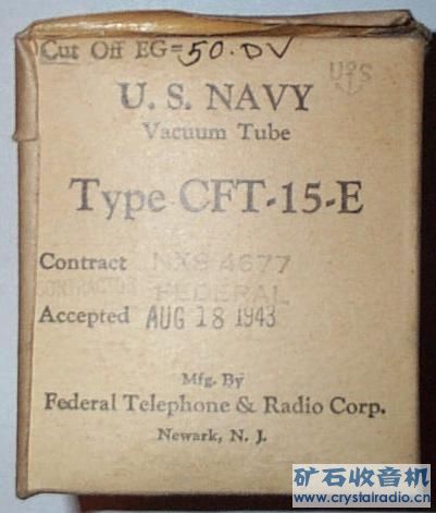

请海河老兄瞧瞧
15E
Power TriodeBase & BulbMechanical DataEIA Base ...................................... F51
Electrical DataHeater Voltage ................................ 5.5 V
Heater Current ................................ 4.2 A
Direct Interelectrode Capacitances (approx)Triode
Input ......................................... 1.4 pf
Output ........................................ 0.3 pf
Grid to Plate ................................. 1.15 pf
Maximum Ratings (Design Center Values)Triode
Plate Dissipation ............................. 20 W
Characteristics and Typical OperationClass C Oscillator/Amplifier
Plate Voltage ................................. 2000 V
Grid No. 1 Voltage ............................ -130 V
Grid No. 1 Current ............................ 18 mA
Plate Current ................................. 63 mA
Driving Power ................................. 4.0 W
Power Output (approx) ......................... 100 W
Plate Voltage ................................. 1500 V
Grid No. 1 Voltage ............................ -95 V
Grid No. 1 Current ............................ 13 mA
Plate Current ................................. 67 mA
Driving Power ................................. 2.2 W
Power Output (approx) ......................... 75 W
Plate Voltage ................................. 1000 V
Grid No. 1 Voltage ............................ -70 V
Grid No. 1 Current ............................ 9 mA
Plate Current ................................. 72 mA
Driving Power ................................. 1.3 W
Power Output (approx) ......................... 47 W
Characteristics and Typical OperationPush Pull Class B Amplifier
Grid No. 1 Voltage ............................ -80 V
Grid No. 1 Current ............................ 270 Vgg mA
Plate Current (Zero Signal) ................... 16 mA
Plate Current (Maximum Signal) ................ 80 mA
Driving Power ................................. 0.7 W
Load Resistance ............................... 55.5K Ω
Power Output (approx) ......................... 110 W
Searched 20770 records on 3667 tube types
发表于 2008-12-24 12:01:54 | 显示全部楼层
参数和四大哥的内容一样。

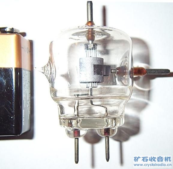

发表于 2008-12-24 14:26:38 | 显示全部楼层
谢谢各位老师热心指导......其实这管子我也没有,呵呵
  看见不练版主发的照片,感觉跟普通9V叠成电池差不多大,我原以为要跟FU-29那么大了....
作为输出管,屏耗只有20W似乎小了一点。 这个“右派”跟普通右派不太一样啊,我觉得普通的右特性管子的栅极偏压为正时才有栅流,这个的栅压在负好几十伏时就有栅流啊.............
  没有特性曲线还是不好利用吧....
发表于 2008-12-24 15:21:15 | 显示全部楼层
這樣小的管子,功率居然這麼大
发表于 2008-12-24 15:51:35 | 显示全部楼层
屏耗20W,不大啊,您是说输出功率吗???呵呵,我也正纳闷了
 楼主| 发表于 2008-12-24 16:22:22 | 显示全部楼层
回复 23# 海河 的帖子
丙类放大。
发表于 2008-12-24 16:50:22 | 显示全部楼层
B类推挽放大,能输出100W的功率,呵呵不小了.....    飞跃50用FU-7已经接近AB类的极限了,才输出50W,实际还到不了50W
