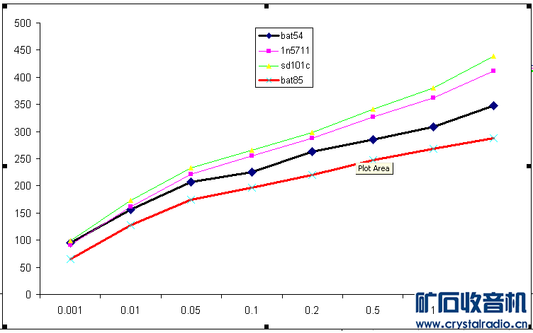

As promised, here are the v-i curves for some RF diodes (1n5711 / e3po special request, bat54, bat85s, and sd101c).
A few observations:
1) they have substantially lower Vfwd than silicon diodes. at 50ua If or lower, Vfwd for the RF diodes is generally around 200mv, vs. 450 - 500mv for silicon diodes.
2) BAT85 beats out everyone hands down: wow! I did get them for low Vfwd but I never realized they would be this low, especially vs. 1n5711 / sd101.
3) SD101 - what a disappointment. I got it after some research for its low Vfwd. totally not worth it.
4) 1n5711 - quite frankly, I don't see what's in it (other than lower prices and better availability).
5) BAT54: not bad. especially considering that I got a reel (3000 pieces) of it for free.
I think if you are building a crystal radio, you should seriously look into BAT85/54.
I have some hsms and 1n60p somewhere but will publish their v-i curves when I find them.
I will try some highspeed schottky diodes' v-i curves tomorrow. Those are for rectification purposes, however.
 楼主| 发表于 2012-9-30 08:39:56 | 显示全部楼层
i may have found the archille's hill for bat54/bat85: the capacitance. being 200ma diodes, their Ct is rated 10pf max. the Ct-Vr curve for those diodes is pretty steep for Vr < 5v.
most germanium diodes in comparison have Ct of 1pf max.
so bat54/85 could still be used for low level am detection (crystal radio). it may not be efficient for sw / fm detection.

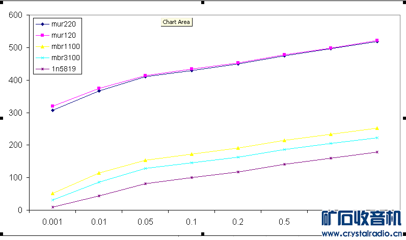

to complete the picture, here are the v-i curves for some ultrafast silicon / schoottky diodes.
Those diodes are not meant for use as detectors - they are tested here just for fun.
mur120 / 220 are widely used in high-end audio preamps or even cd players / transport.
mbr / 1n5819 are schoottky diodes. 1n5819 is specifically designed for its low Vfwd drop, and it shows here. for If < 50ua, Vfwd < 100mv for 1n5819.
All those diodes have significant Ct. 1n5819 for example has Ct from 10pf - 100pf+, making an ideal diode for use as a variable capacitor in a voltage tuned am/sw radio.

      Thanks!
      fyi:
           HSMS diodes are tiny and pricy.
