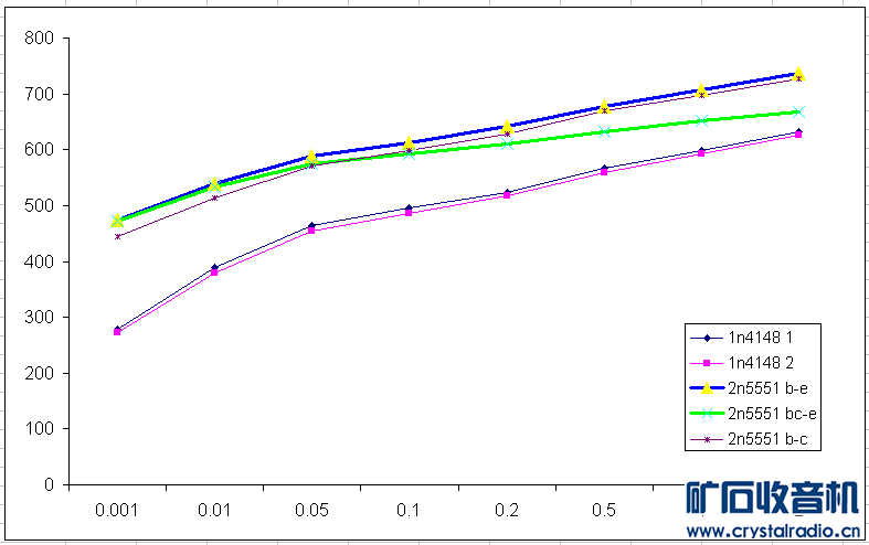

with some free time today, i decided to try to plot out the v-i curves for some of the more common diodes. the part I am interested is am detector so I am more focused on small signal levels.
I tried a few rectifying diodes (1n400x), some leds and then some signal diodes / transistors.
here is the part of signal diodes (in this case, 1n4148, and 2n5551's b-e junctions).
the two curves on the bottom are for two 1n4148s from ONSemi. as you can see, they track each others very closely.
the blue and the green lines are for a 2n5551's b-e junction (the blue trace) and then as an amplified diode (bc-e junction, the green trace). As you can see, the v-i curve is much flatter with b/c tied together.

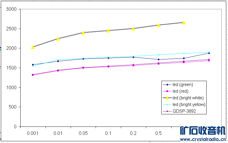

here are v-i curves for some leds.
both red and bright yellow leds are pretty good as a voltage reference. QDSP-3892 is a HP red 7-segment led.

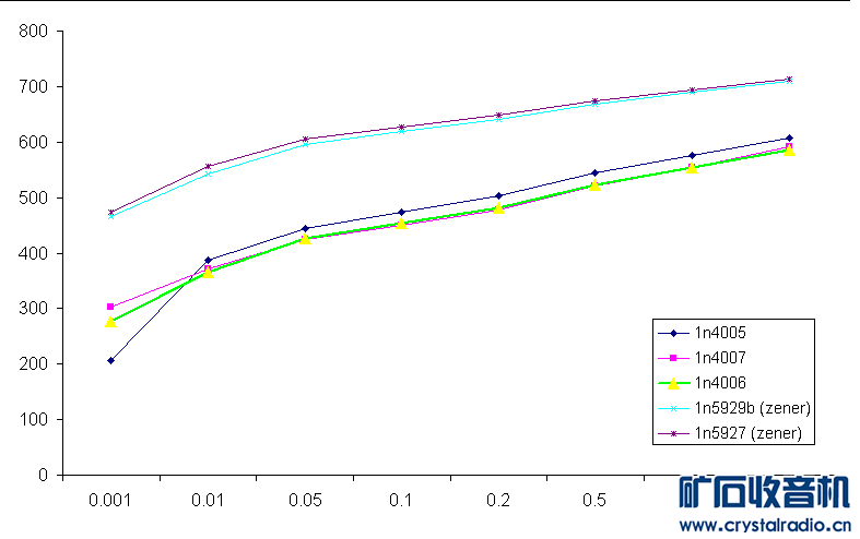

similarly, here are the v-i curve for the rectifying diodes (and a couple zeners).
1n4006/4007 are highly alike. and the zeners (1n5929/1n5927) are highly alike.

btw, the Y-axis is mv, and X-axis is ma.

the behavior of 1n4148 is a little bit surprising to me in that it opens like 250mv or so (@ If = 1ua), making it almost like a schottky diode. I guess schottkies can potentially start conducting at even lower Vfwd at a comparable If.

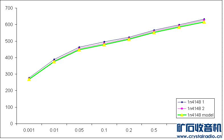

when you simulate a circuit, you often wonder how accurate those models.
here, I used ltspice's 1n4148 model and plotted its theoretical v-i curve (in green) vs. the measured 1n4148 v-i curves (two thinner lines as I had measured two 1n4148s).
they are right on top of each other. the error rate is about 2%.
Wow! you have to give ltspice credit for being this accurate.
