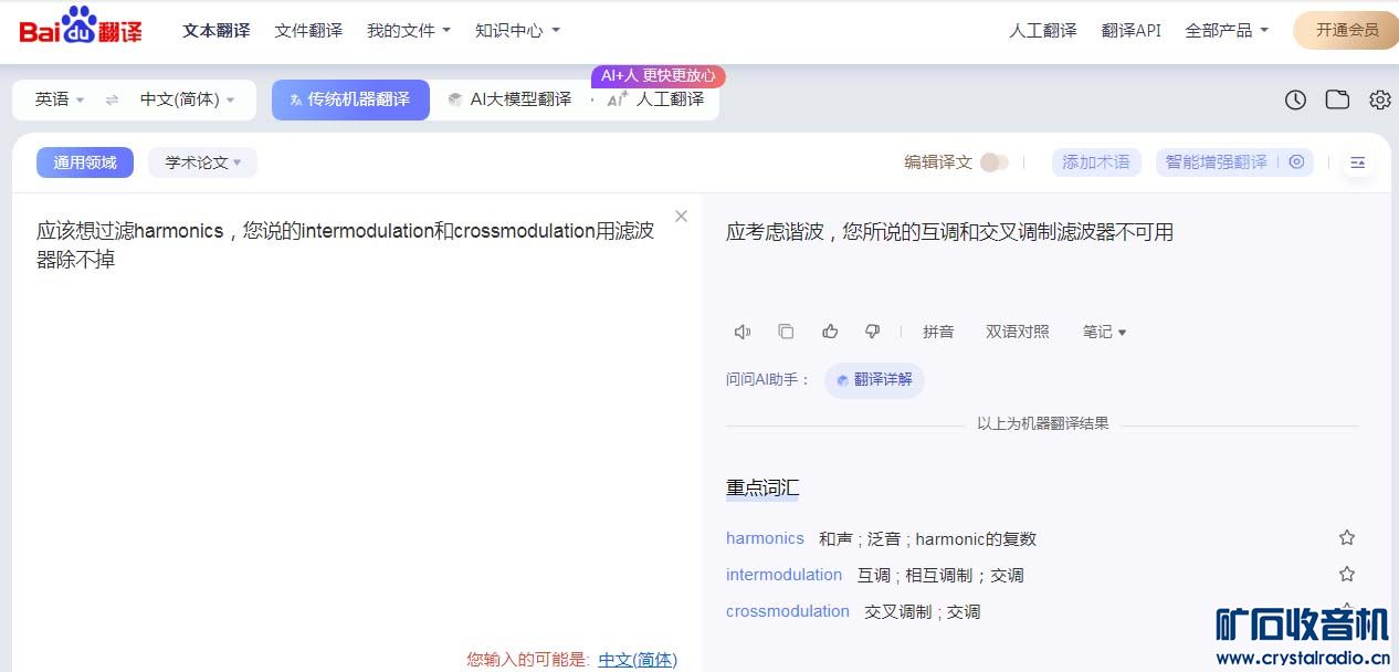

应该想过滤harmonics,您说的intermodulation和crossmodulation用滤波器除不掉
还是像黑话,土匪窝里人人都懂,其他人听不懂 。要想听懂就得学他们的话。

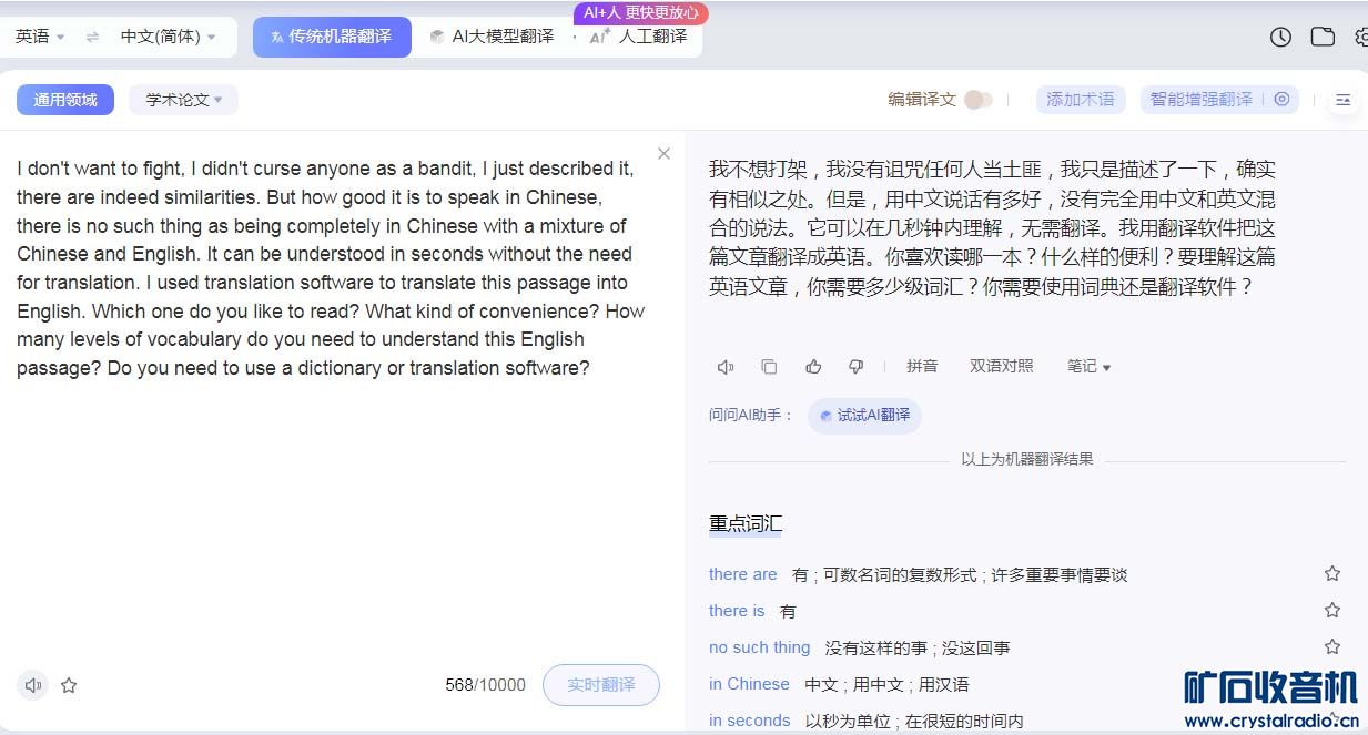

发表于 2024-12-31 20:58:35 | 显示全部楼层
longshort 发表于 2024-12-31 09:25
這怎麽是黑話?別把人全看成土匪,您的技術還是從您那“土匪窩”裏學來的,學一點英語怎麽啦?對您只有好 ...
I don't want to fight, I didn't curse anyone as a bandit, I just described it, there are indeed similarities. But how good it is to speak in Chinese, there is no such thing as being completely in Chinese with a mixture of Chinese and English. It can be understood in seconds without the need for translation. I used translation software to translate this passage into English. Which one do you like to read? What kind of convenience? How many levels of vocabulary do you need to understand this English passage? Do you need to use a dictionary or translation software?
不想打架,没骂别人土匪,只是形容,确实有相似之处。但是用中文说多好,中英文混杂哪有全中文好,一目十行秒懂,不需要翻译。我用翻译软件把这段话翻译成英文,你喜欢看哪种?哪种方便?你看懂这段英文需要几级词汇?需要不需要翻词典或借助翻译软件?
