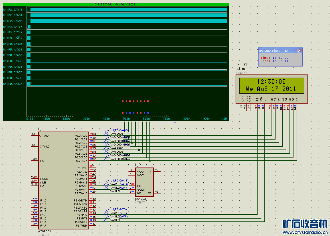

here is an example as to how I would have structured it.
1) I would have split the files into a lcd module (lcd_4bit) and a ds1302 module (ds1302), plus a user module.
2) in the user module, I would simply call the functions defined by lcd_4bit.h/ds1302.h, with the confidence that they would work.
3) the lcd_4bit/ds1302 modules are written so that the user has the ability to customize the pins. recompile and the code will work.
here is an example, 100% simulated.
notice that the lcd control pins and the ds1302 pins differ from your implementation.

to make it complete, here is the lcd_4bit module:

发表于 2011-11-15 06:02:57 | 显示全部楼层
here is the ds1302 module
============ds1302.h==============
here is the user module.
main.rar (4.76 KB, 下载次数: 175)
notice how it utilizes the lcd_4bit/ds1302 modules.
发表于 2011-11-15 06:08:23 | 显示全部楼层
a couple quick suggestions:
1) your code could have been structured much better: many of the display functions are too tangled together.
2) you should reduce the use of global variables.
发表于 2011-11-15 06:09:02 | 显示全部楼层
one more suggestion:
always, always, comment on your code.
发表于 2011-11-15 06:10:46 | 显示全部楼层
about those two modules (lcd_4bit/ds1302).
you will notice that in the .h files, there is a section called "hardware configuration".
if you ever change the connections, you can simply redefine those pins there, and recompile the code. it will work, without any changes to the corresponding .c files.
