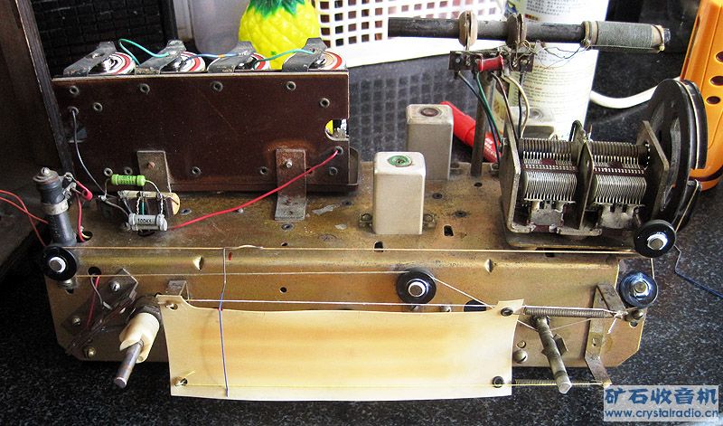

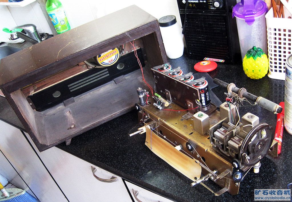

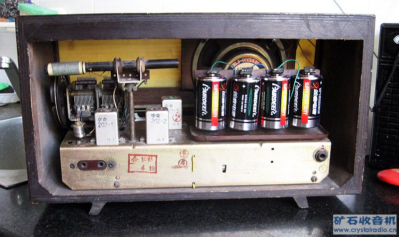

到手简单擦擦,拆下喇叭装回玻璃度盘,调整下磁棒上的线圈(因为看上去被人移动过位置),整机就很好的工作了。
对了,机器来时缺少频率指针,找不到合适的材料,最后用印刷厂的装订铁丝弯了一个对付上去,比原来细,看上去不太显眼。

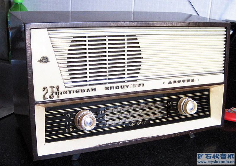

这是当时晶体管台式机的顶端机。其时还有四厂凯歌4B1, 也是相当不错的机器,2J1的外壳要比后来该厂的工农兵,红灯同型机子好看得多。非常喜欢它的罐式半可变电容。

用一段红色的塑胶电线外皮套在指针上应该好些。

it is actually amazing that we made such a good looking and quite sophisticated radio back then. If you look at the commercial products in the west around that era, this radio would compare favorably.
it is just somehow the rest of the world took off in the late 1960 / 1970s and we kind of stood still.

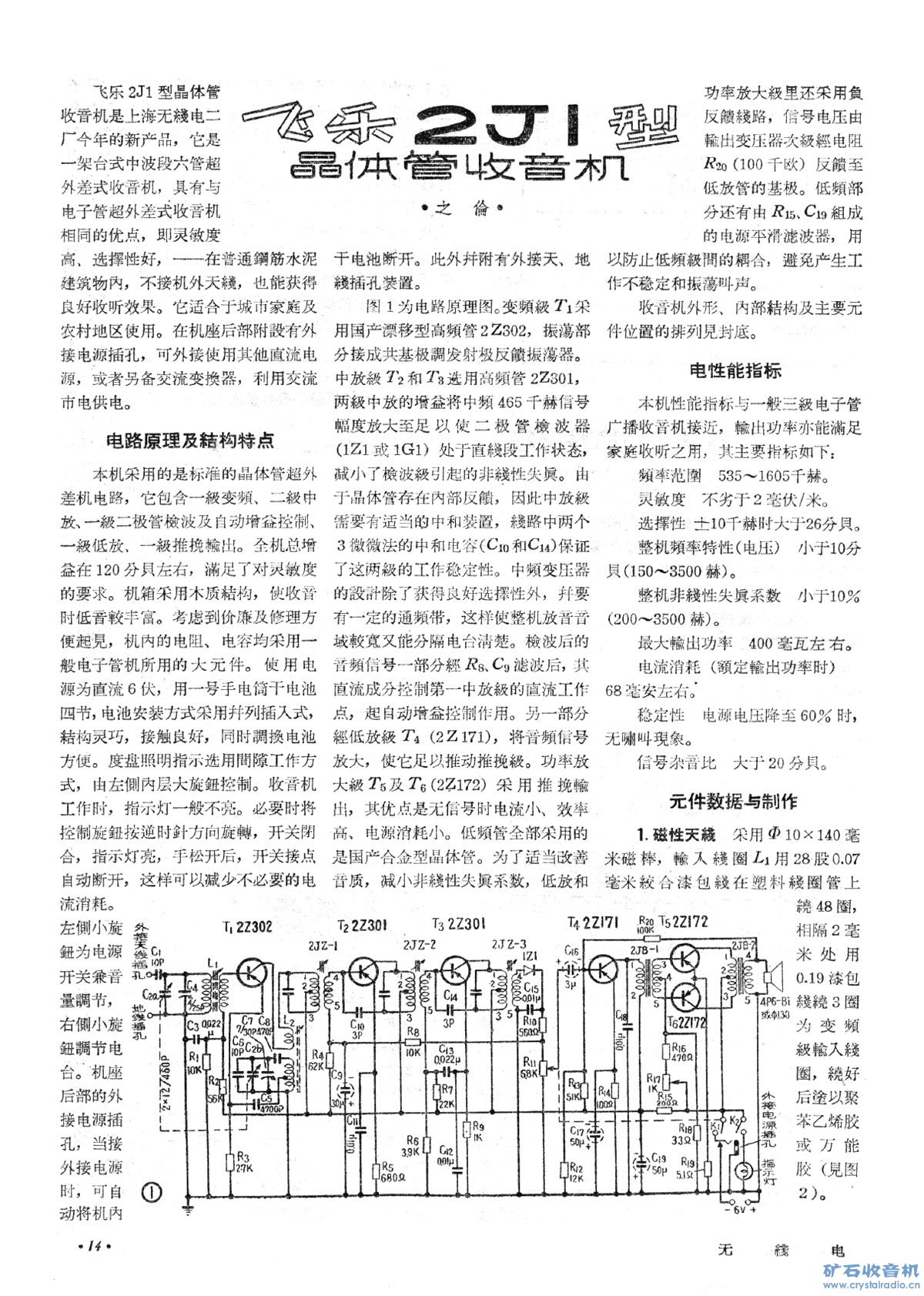

R17好像被换过了。

好大的中周.

越看越似电子管机,连文字表述、原理图画得都象电子管的。
