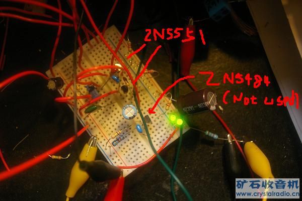

 楼主| 发表于 2010-9-4 02:05:04 | 显示全部楼层
I know I owe you a picture, so here it goes.
the breadboard on the left is the mosfet varicap (there is a polycap, unused right now). and the radio itself is on the right.
 楼主| 发表于 2010-9-4 02:08:53 | 显示全部楼层
here is the radio. there are three to92 devices there. the first two are for the radio (2n5551x2), and the last one, on the right, is a 2n5484 (jfet) and at this point it is unused.
the two leds provide a 4v power supply to the radio. the power comes from a 16vdc notebook power adapter.
 楼主| 发表于 2010-9-4 02:12:02 | 显示全部楼层
here is the mosfet varicap. the mosfet (fqp1n50) is a dpak device, and you can barely see it.
it takes just the left side of the breadboard. the right side I think is an oscillator.
