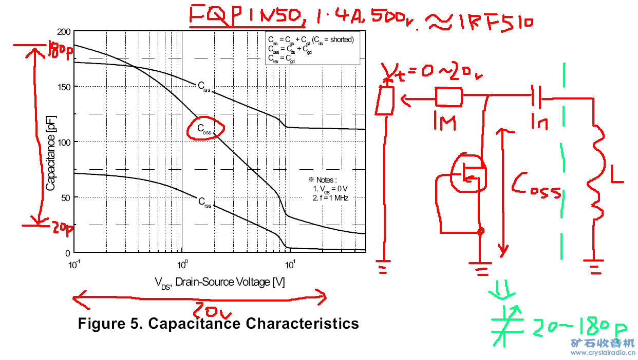

another item that's hard to come by and expensive to buy here is a varicap. air varicaps are typically $20 + each.
I have thought about a variety of means to replace that, from using reverse biased LEDs to rectifiers / zeners.
I was just reading a datasheet today and it came to me suddenly that mosfet's gate capacitance can be used as a varicap.
here is the basic concept: the output capacitance of a mosfet varies with its Vds. so if we could change the Vds on a mosfet with a pot, we have got us a varicap.
the next trick is to find the mosfet with the right range of Coss. usually small current TO220 have about 100pf Ciss and 200pf Coss. I picked FQP1N50 since I have many of them. But you can pick similar devices, like IRF510.
larger mosfets, like IRF540, do not work here as their Coss is too big.
so here it is. I will try to play with it later to see if it works.
 楼主| 发表于 2010-8-17 09:11:18 | 显示全部楼层
I am happy to report that this approach absolutely works.
I wired mine up, powered by a 16v switch mode power supply and I was tuning radio stations to radio stations from a little trimmer!
give it a try and you may just like it.
also, to filter ripple, you may want to put a 4.7uf cap from the wiper of the pot to the ground. Mine worked without it, though.
