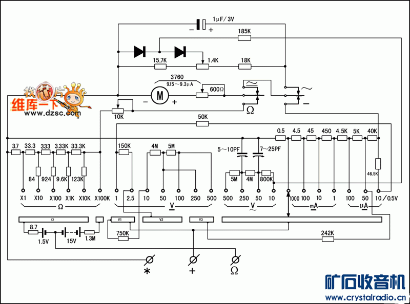

MF10 its a best multimeter with size , durable, high sensitives but one problem in semiconductor decade its using 1.5V battery for resistor range . 1.5V not enough for test led diode, igbt and mosfet . 1.5V quite hard to check point angle of LI/LV function . Hope any master can research and modifier MF10 change batery from 1.5v to 3V .

你能把MF10的电路图上传来看看吗?

I am on the bus frome home to office , so when arrived office i will post MF10 schematic ! MF10 using one 1.5V C Size and one 15v battery ! But 1.5v not enough for test led voltage drop and mosfet

I dont have U201 . I forcus about change to 3V in resistor range x1 x10 x100 x1k x10k . With 3V battery angle pointer will have larger than 1.5v ! So easy for view in LI/LV mode .

印象中,欧姆档使用的电池的电压和内阻对电阻测试结果没有影响的。所以感觉将那个1.5V电池左侧的8.7Ω的电阻改个大点的阻值应该就可以。
可以这样操作:直接用3V电池,然后找个可调电阻替换8.7Ω的电阻,调节此电阻,让欧姆档x1 x10 x100 x1k x10k都可以调零就行了。

对于楼主所提出的问题,即是把MF10的1.5V供电改为3V供电,我以前曾经研究过一番。记得该表的欧姆档设计比较特殊,不同档位之间的电阻取值会互相牵扯,为此,当时还动用multisim做过辅助计算。
但由于该表的电池仓不方便改成3v电池,加上我还想手头保留有1.5V供电的指针表(我手头的指针表以3V表居多),我最终没把手头的MF10A做这样的改造。
发表于 2024-1-12 10:47:04 | 显示全部楼层
