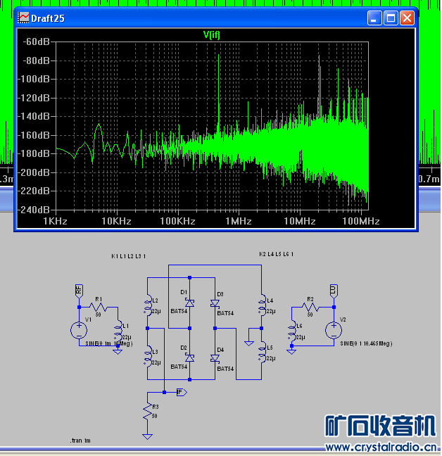

Here is a diode mixer at work.
RF signal is 1mv @ 1MHz; LO is 1v @ 10.465Mhz. The IF signal generated is about -80db @ 465Khz, just as expected.

发表于 2013-5-2 08:58:17 |
that's expensive!!
That's not a bad price. But making one is definitely more fun.
