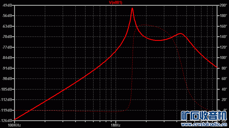

Here is a sim using the BF998 model posted above:

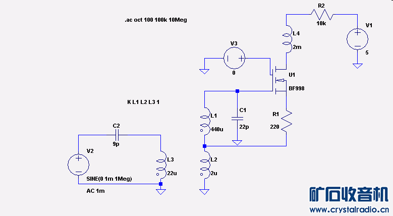

Here is the .asc file:
  1. Version 4
  2. SHEET 1 880 680
  3. WIRE 352 0 288 0
  4. WIRE 496 0 432 0
  5. WIRE 288 32 288 0
  6. WIRE 496 32 496 0
  7. WIRE 96 128 48 128
  8. WIRE 240 128 176 128
  9. WIRE 288 144 288 112
  10. WIRE 496 144 496 112
  11. WIRE 48 160 48 128
  12. WIRE 240 176 240 128
  13. WIRE 144 224 48 224
  14. WIRE 240 224 144 224
  15. WIRE 48 272 48 224
  16. WIRE 144 272 144 224
  17. WIRE 288 272 288 240
  18. WIRE -240 352 -320 352
  19. WIRE -80 352 -176 352
  20. WIRE 144 368 144 336
  21. WIRE 48 384 48 352
  22. WIRE 288 384 288 352
  23. WIRE 288 384 48 384
  24. WIRE -320 400 -320 352
  25. WIRE -80 400 -80 352
  26. WIRE 48 400 48 384
  27. WIRE -320 496 -320 480
  28. WIRE -80 496 -80 480
  29. WIRE -80 496 -320 496
  30. WIRE -80 512 -80 496
  31. WIRE 48 512 48 480
  32. FLAG 144 368 0
  33. FLAG -80 512 0
  34. FLAG 48 512 0
  35. FLAG 496 144 0
  36. FLAG 48 160 0
  37. SYMBOL myLib\\BF998 240 144 R0
  38. SYMATTR InstName U1
  39. SYMBOL res 304 368 R180
  40. WINDOW 0 36 76 Left 0
  41. WINDOW 3 36 40 Left 0
  42. SYMATTR InstName R1
  43. SYMATTR Value 220
  44. SYMBOL ind2 32 256 R0
  45. SYMATTR InstName L1
  46. SYMATTR Value 440?
  47. SYMATTR Type ind
  48. SYMBOL ind2 32 384 R0
  49. SYMATTR InstName L2
  50. SYMATTR Value 2?
  51. SYMATTR Type ind
  52. SYMBOL ind2 -96 384 R0
  53. SYMATTR InstName L3
  54. SYMATTR Value 22?
  55. SYMATTR Type ind
  56. SYMBOL ind 272 16 R0
  57. SYMATTR InstName L4
  58. SYMATTR Value 2m
  59. SYMBOL res 448 -16 R90
  60. WINDOW 0 0 56 VBottom 0
  61. WINDOW 3 32 56 VTop 0
  62. SYMATTR InstName R2
  63. SYMATTR Value 10k
  64. SYMBOL cap 128 272 R0
  65. SYMATTR InstName C1
  66. SYMATTR Value 22p
  67. SYMBOL voltage 496 16 R0
  68. WINDOW 123 0 0 Left 0
  69. WINDOW 39 0 0 Left 0
  70. SYMATTR InstName V1
  71. SYMATTR Value 5
  72. SYMBOL voltage -320 384 R0
  73. WINDOW 123 24 132 Left 0
  74. WINDOW 39 0 0 Left 0
  75. SYMATTR Value2 AC 1m
  76. SYMATTR InstName V2
  77. SYMATTR Value SINE(0 1m 1Meg)
  78. SYMBOL cap -176 336 R90
  79. WINDOW 0 0 32 VBottom 0
  80. WINDOW 3 32 32 VTop 0
  81. SYMATTR InstName C2
  82. SYMATTR Value 9p
  83. SYMBOL voltage 192 128 R90
  84. WINDOW 0 -32 56 VBottom 0
  85. WINDOW 3 32 56 VTop 0
  86. WINDOW 123 0 0 Left 0
  87. WINDOW 39 0 0 Left 0
  88. SYMATTR InstName V3
  89. SYMATTR Value 0
  90. TEXT -184 16 Left 0 !.ac oct 100 100k 10Meg
  91. TEXT -176 256 Left 0 !K L1 L2 L3 1
复制代码
Enjoy.

补上图:
