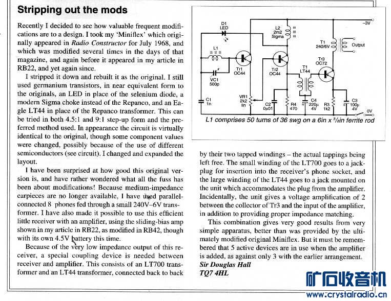

Hall was a famed radio builder in the 1960s / 1970s.
in 1968, he published the original Miniflex, and that was a hit:
various revisions were made since then, and mkiii came in 1971:
I thought it was interesting that a) he used an led as the detector and then b) how he implemented a reflex radio.
I never built it myself but in case you are interested.

用LED检波的迷你耒复机在发光管还是稀罕新鲜物的上世纪60年代也许还能哗众取宠,但在电磁环境i恶劣,各种元器件变得廉价丰富唾手可得的今天应该是毫无价值可言。

yeah. Hall is one of those amazingly productive dudes who just kept on producing.
