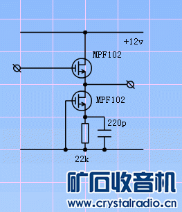

here is a link to a website that talks about am detector.
click on the audio link in the middle and be surprised about the high quality am sound.
http://www.mds975.co.uk/Content/crystalsets5.html
发表于 2012-9-14 11:06:11 | 显示全部楼层
看了一下,文所介绍的高品质检波器是这样的:
用恒流源作检波负载,减小音频损失和失真。
