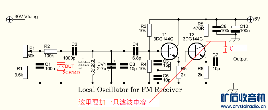

这是我正在试制的电调谐调频收音机的本振电路,就是在楼主的电路基础上加以改进的,加了射随器,把原来正极接地改为负极接地。即并联调谐电容三点式振荡器,也叫锡拉振荡器。
发表于 2012-7-1 01:29:29 |
Colpitts oscillators usually have very low output impedance so a buffer isn't necessary, most of the times.
Not sure of 3dg144s but using a common base colpitts oscillator here would be a good idea if T1 has low ft (anything less than 300Mhz for the FM band).

发表于 2012-7-1 09:15:41 |
在这里再加上一只滤波用的电容C,就更好了。
