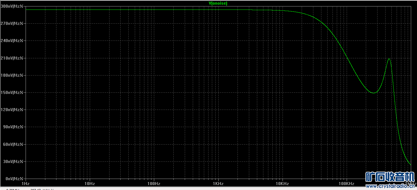

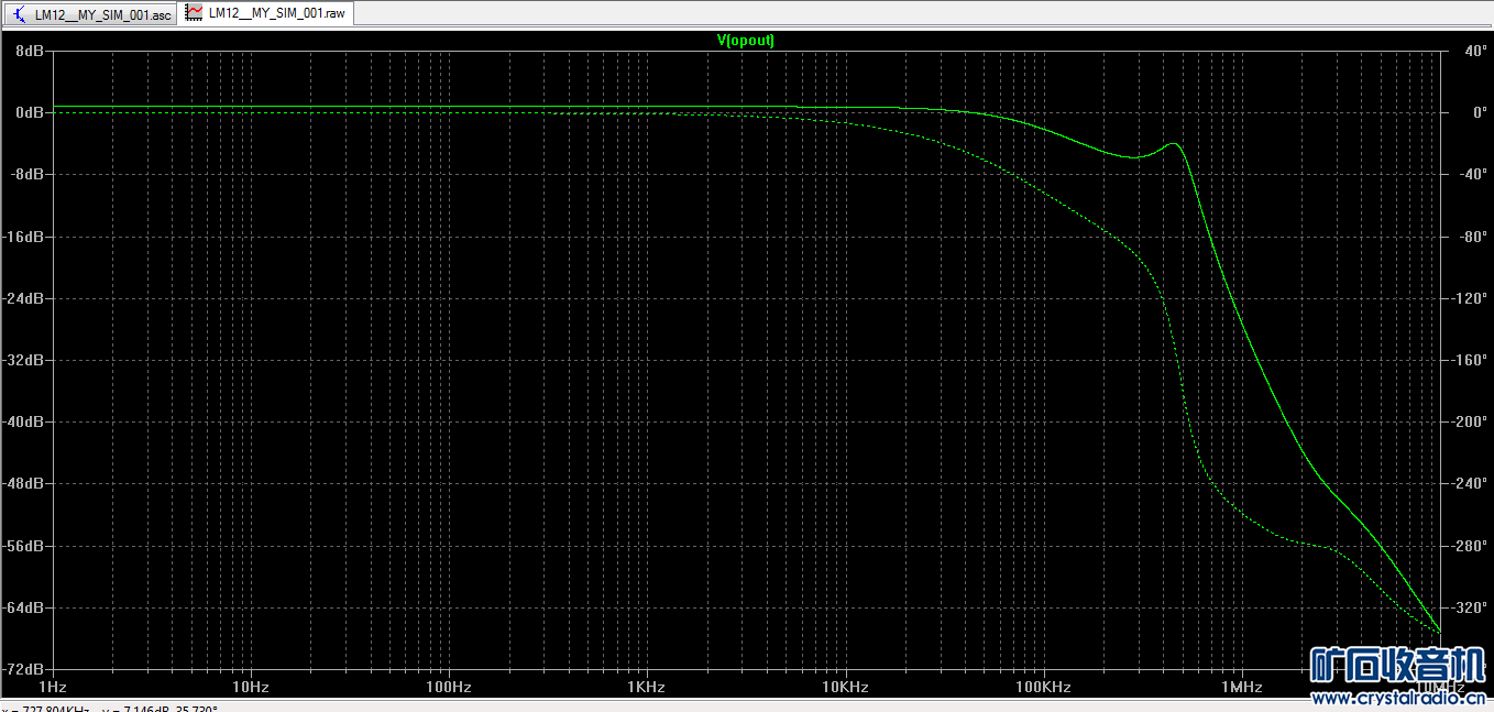

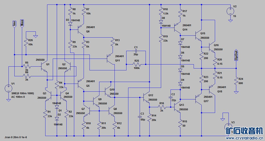

LM12 内部电路的仿真

 楼主| 发表于 2012-5-8 11:20:36 |
看起来不怎么样先进啊

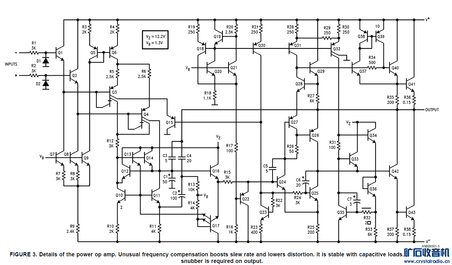

发表于 2012-5-8 16:35:15 |
LM12的电路不是这样吧
国办AN-446B文档就是专门描述LM12内部电路的,
很小的静态电流,但经过一个巧妙的电路,得到较高的电压摆幅速率。
 楼主| 发表于 2012-5-8 16:46:33 |
locky_z 发表于 2012-5-8 00:35
LM12的电路不是这样吧
This monolithic op amp is compensated for unity-gain feedback,
with a small-signal bandwidth of 700 kHz. Slew rate is
9V/μs, even as a follower. Distortion and capacitive-load stability
rival that of the best designs using complementary output
transistors. Further, the IC withstands large differential
input voltages and is well behaved should the common-mode
range be exceeded.
The LM12 establishes that monolithic ICs can deliver considerable
output power without resorting to complex switching
schemes. Devices can be paralleled or bridged for even
greater output capability. Applications include operational
power supplies, high-voltage regulators, high-quality audio
amplifiers, tape-head positioners, x-y plotters or other servocontrol
systems.
plz refer to Page 14   of the datasheet,
http://www.ti.com/lit/ds/symlink/lm12cl.pdf
http://www.ti.com/lit/an/snoa761/snoa761.pdf

发表于 2012-5-8 20:36:47 |
楼主老师下了大工夫了
看频响曲线,从20K 开始明显衰减,
难道电路是专为音频而设计的
发表于 2012-5-8 21:31:00 |
难道电路是专为音频而设计的
it was designed as a servo.

发表于 2012-5-9 21:33:26 |
不知Q7那样的双发射极晶体管怎么仿真为好.
发表于 2012-5-10 12:28:49 |

 楼主| 发表于 2012-5-10 13:18:52 |
        这个估计 millwood 会知道.
       俺觉得 Hspice 的库里面应该有多发射极管的模型
