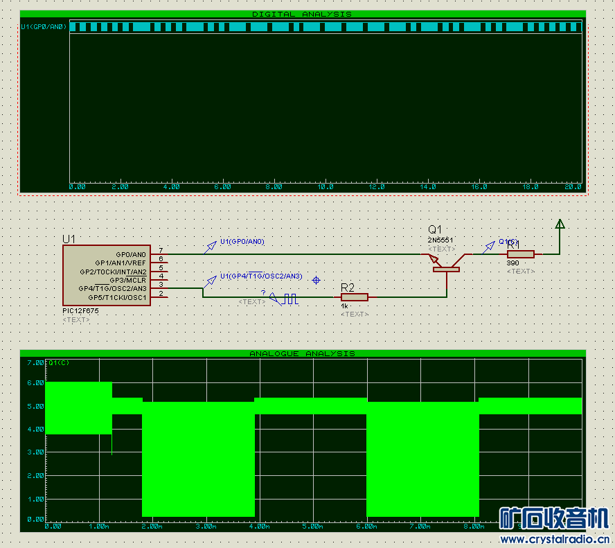

here is what I put together today.
and here is the code:

what is it?
it is a morse code transmitter working on 1Mhz.
the heart of the transmitter is a mcu (in this case, a pic12f675, 8dip). I used the internal 4Mhz rc oscillator. the oscillator is configured so that on GP4 it outputs a 1Mhz RF signal.
the audio signal is generated on GP0 - in this case, it is international morse code for "Hello, world!".
The AF signal is applied to Q1's emitter, to modulate the RF signal applied to Q1's base. the antenna is a short straight wire (4-in in length) on Q1's collector.
when I put my radio to the little transmitter, I could hear the morse code being transmitted.
This can act like a handy 1Mhz signal generator, usefully when you try to get your radio to work.
note to all: it is most likely illegal where you live to operate without a license in the AM band. but this particular transmitter is very low power - the signal dropped out ~5 meters away from the transmitter.
enjoy.
ps: the code is very portable so it should be quite easy to port  it to any mcu (either internal oscillator or crystal).

学习了,单片机还可以这么用,如果主频再高点的话可以发SW波段了.
As the carrier wave is square wave. If putting the audio signal (like voice) to Q1's emitter, dose an AM radio can demodulate it?
 楼主| 发表于 2012-3-12 00:04:36 | 显示全部楼层
it does.
a simpler approach is to use the audio signal to drive the Vcc pin of a crystal oscillator (either passive or active).
that would be the simplest AM radio.
