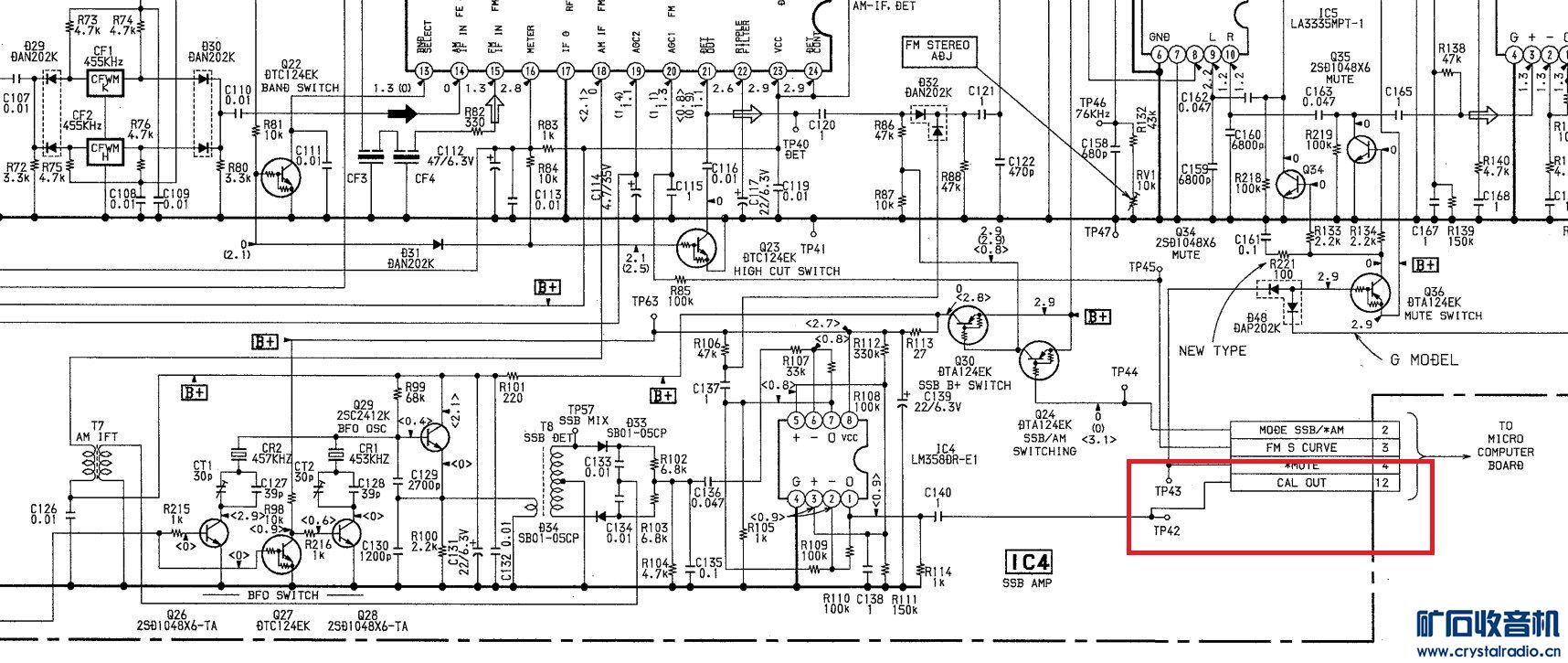

求教群里的大佬一个问题。我在看索尼SW55收音机的电路图,在SSB电路中有个地方不明白,就是那个CAL OUT。SSB检波输出给了运放LM358,然后由运放给立体声解码芯片,这个都能理解。但是信号再加入358放大后用过CAL OUT送给主控芯片,不知道这个是干啥用的。希望知道的大佬指点一下,谢谢。

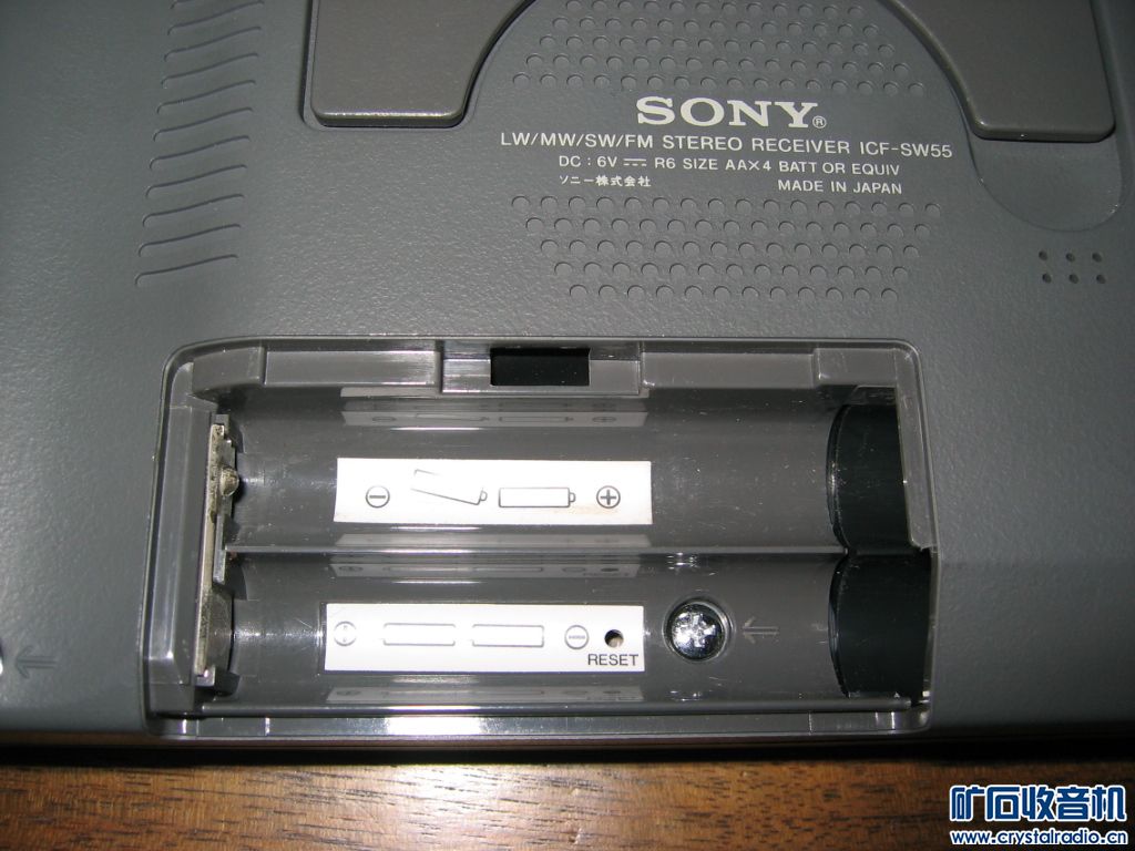

I've just discovered something very interesting about the Sony SW-55
.... a feature hidden in the service documentation. Here is how it
works. Open the battery compartment being sure the AC adaptor is
plugged in and then remove the two lower batteries. There is a hole
marked "reset" ..... and there is another hole just to the left of
the reset hole... under the battery label .... and under that hole
(revealed by peeling back the battery label or just punching a hole
through it) is another switch ... just like the reset switch. You can
use a unbent paper clip or toothpick to press the switch.
After pressing the switch you can turn the radio over and look at the
LCD.... it will read "TAPE I/O" .... pressing the "2" key will make
the display indicate "TAPE OUT" and pressing the <1> Key will cause
the LCD to read "TAPE IN" .....now comes the fun part ... if you plug
a tape recorder into the "LINE OUT" socket and feed it into the
recorder and start recording ... strange digital tones will be
recorded after pressing <2> in the TAPE I/O mode. Likewise, you can
do the reverse, playing back the tones into the radio ....

  Here is a little diagram to show where the second hole is located
below the battery label
        +  {_____] {____o] - reset0
                       | location of hidden hole/switch
You can use a needle to poke on the label till it punches through the
soft spot. I just found it by rubbing my thumbnail over the battery
lable till the outline of the underlying hole was revealed and then
cut a small hole in the label with an Xacto Knife.
                          Robert S. Williams, MD
                          KD4ZPH

发表于 2023-11-12 21:55:06 | 显示全部楼层
SW55是Sony机里的另类,这机有语焉不详的CAL功能,应该与这个信号有关。没机懒得细细看电路了。
比如特定操作或自检模式,某种方式的频标[内部振荡器谐波甚或内部各振荡器无法消除的互调分量?]插入AM通道一路变频下来送到处理器计频核对。

谢谢回复。我主要是想借鉴他的ssb检波电路。主要不知道他这个cal是干啥用的。

发表于 2023-11-13 20:58:33 来自手机 | 显示全部楼层
二楼说的很有道理 这个cal定义模糊 事实上sw55的cal应该是定义为开机自检 sw55还可以在am function状态在开机状态下做一次cal 这里标记cal out有点误导的倾向。事实上 ssb信号检波后进入ssb放大器芯片,一路输出进入中放 另一路就在楼主提及的这个cal out通过非门进入CPU的 TI0 也就是CPU芯片的45脚 这是CPU的timer的输入脚 您可以看一下CPU的46脚 是PTO0 可以做输入输出引脚 这里是输入 信号来源是通过非门的中放信号 看不到CPU驱动程序 我认为是根据这两路信号输入判断是ssb还是非ssb然后产生进一步的信号处理指令 看不到源程序只能这么推测一下 仅供参考
发表于 2023-11-13 21:04:08 来自手机 | 显示全部楼层
为什么说cal out是误导呢?因为在收音板上面标识cal out 但是 在CPU板子上就是标记if counter,就是做中频计量 所以我认为CPU驱动程序就是看如果两路输入都是00 那么就是ssb信号无疑 如果是10那么就是非ssb 跟进采样CPU做不同指令 具体得看源代码了 把机器码搞出来研究才行

发表于 2023-11-14 13:29:39 来自手机 | 显示全部楼层
Jambalaya 发表于 2023-11-14 10:51
电路图有体现数据口。就像老式计算器单板机们用的FSK调制,用录音带存取。
挺有意思哈 这个隐藏的功能很有意思 确实电脑版到收音板 有一个通道是data out……电脑版上下面并排两个开关 没想到其中一个是做这个的……维修服务手册我读了 里面不但没提这个功能 反而建议大维修的情况下把原机的电台信息存贮芯片摘下来换到新板子上防止预设电台信息丢失……另外 我倒是看过几个型号的sony收音机电路和电路板  sw55的制版确实有点特殊 精细了很多很多 感觉 sw55研发团队里面做单片机背景的人应该很强 并且是个leader有决定权 我在想会不会CPU程序也有办法通过这个通道能读出来呢?
