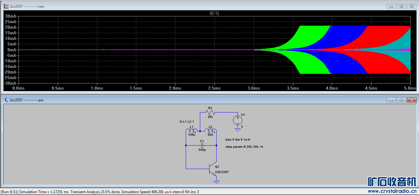

 楼主| 发表于 2011-7-30 03:33:00 |
回复 1# e3po
    本例 (1500MHZ 振荡器 ) 就用了 NEC 的 2SC3357  自定义模型

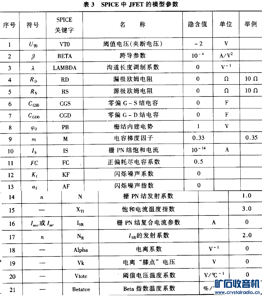

 楼主| 发表于 2012-3-28 14:29:16 |
BJT
Model parameters
Spice Gummel–Poon model parameters
#         Name         PropertyModeled         Parameter                     Units         DefaultValue
1         IS         current         transport saturation current         A         1.00E-016
2         BF         current         ideal max forward beta         -         100
3         NF         current         forward current emission coefficient         -         1
4         VAF         current         forward Early voltage         V         inf
5         IKF         current         corner for forward beta high current roll-off         A         inf
6         ISE         current         B-E leakage saturation current         A         0
7         NE         current         B-E leakage emission coefficient         -         1.5
8         BR         current         ideal max reverse beta         -         1
9         NR         current         reverse current emission coefficient         -         1
10         VAR         current         reverse Early voltage         V         inf
11         IKR         current         corner for reverse beta high current roll-off         A         inf
12         ISC         current         B-C leakage saturation current         A         0
13         NC         current         B-C leakage emission coefficient         -         2
14         RB         resistance         zero-bias base resistance         ohms         0
15         IRB         resistance         current where base resistance falls half-way to its minimum         A         inf
16         RBM         resistance         minimum base resistance at high currents         ohms         RB
17         RE         resistance         emitter resistance         ohms         0
18         RC         resistance         collector resistance         ohms         0
19         CJE         capacitance         B-E zero-bias depletion capacitance         F         0
20         VJE         capacitance         B-E built-in potential         V         0.75
21         MJE         capacitance         B-E junction exponential factor         -         0.33
22         TF         capacitance         ideal forward transit time         s         0
23         XTF         capacitance         coefficient for bias dependence of TF         -         0
24         VTF         capacitance         voltage describing VBC dependence of TF         V         inf
25         ITF         capacitance         high-current parameter for effect on TF         A         0
26         PTF                 excess phase at freq=1.0/(TF*2PI) Hz         deg         0
27         CJC         capacitance         B-C zero-bias depletion capacitance         F         0
28         VJC         capacitance         B-C built-in potential         V         0.75
29         MJC         capacitance         B-C junction exponential factor         -         0.33
30         XCJC         capacitance         fraction of B-C depletion capacitance connected to internal base node         -         1
31         TR         capacitance         ideal reverse transit time         s         0
32         CJS         capacitance         zero-bias collector-substrate capacitance         F         0
33         VJS         capacitance         substrate junction built-in potential         V         0.75
34         MJS         capacitance         substrate junction exponential factor         -         0
35         XTB                 forward and reverse beta temperature exponent         -         0
36         EG                 energy gap for temperature effect of IS         eV         1.1
37         XTI                 temperature exponent for effect of IS         -         3
38         KF                 flicker-noise coefficient         -         0
39         AF                 flicker-noise exponent         -         1
40         FC                 coefficient for forward-bias depletion capacitance formula         -         0.5
41         TNOM                 parameter measurement temperature         deg.C         27
