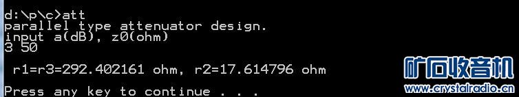

发表于 2022-1-20 15:13:18 | 显示全部楼层 |阅读模式
    for attenuator design.
    file name is att.c.
    by cxd.  2021.9.11
#include<stdio.h>
#include<math.h>
#include<stdlib.h>
int main()
        float  a, z0, k, r1, r2;
        printf("parallel type attenuator design.\n");
        printf("input a(dB), z0(ohm)\n");
        scanf("%f %f", &a, &z0);
        k=pow(10, (-1)*a/20);
        r1=(1+k)/(1-k)*z0;
        r2=(1-k*k)/(2*k)*z0;
        printf("\n r1=r3=%f ohm, r2=%f ohm\n\n", r1, r2);
        /*printf("\n press any key to exit...");
        getchar();*/
        system("pause");
        return 0;
/*10:28 2021/10/5*/

并联型衰减器的电路如图所示.程序根据输入的衰减db数及电路特性阻抗计算衰减器的三个电阻值.
