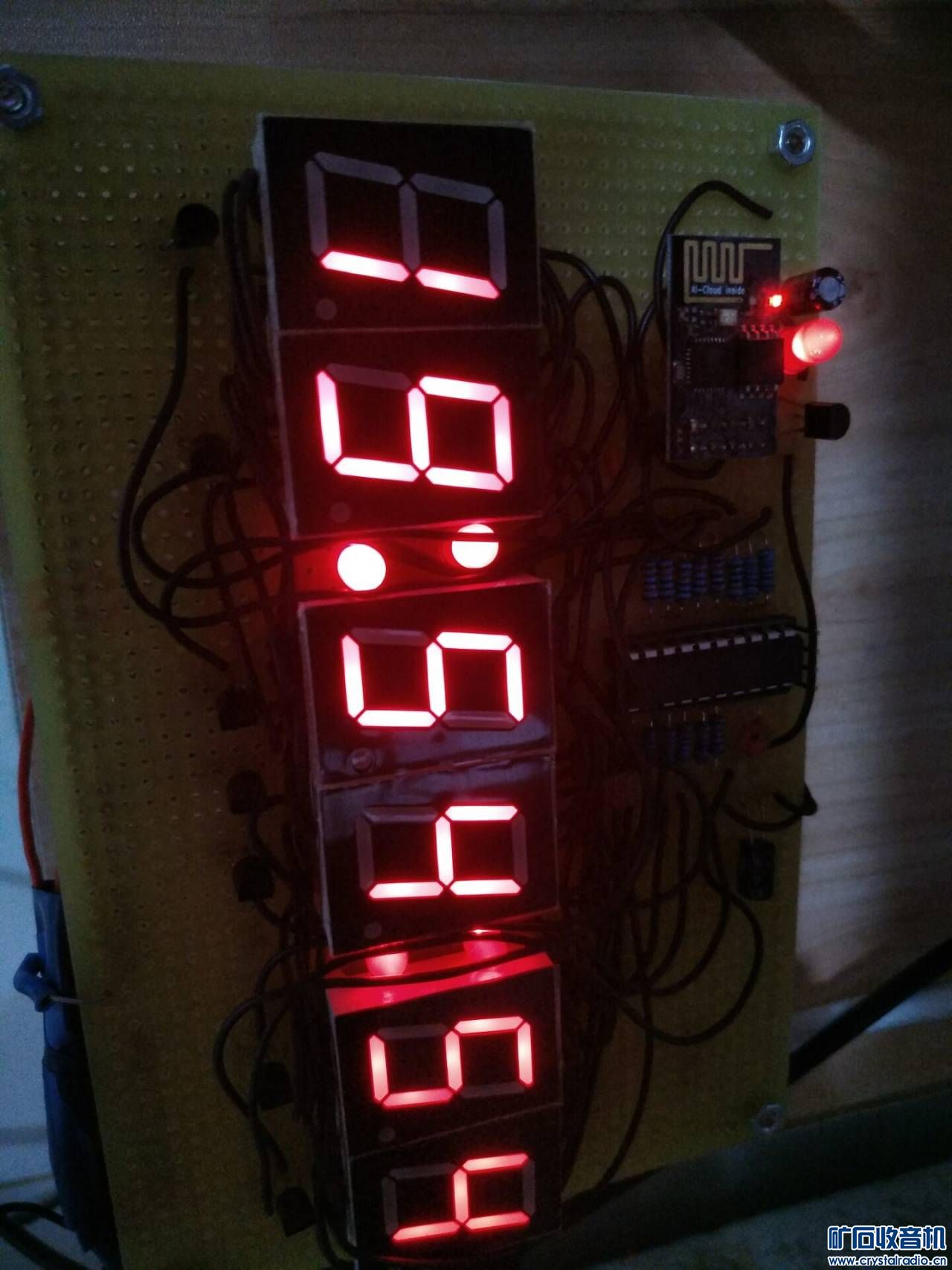

ÓÃÁ½¿éÍòÄܰådiyÒ»Ö»wifiУʱµÄledʱÖÓ£¬Ê±¼ä·Ç³£×¼£¬Ö÷ÒªÓõ½ÁËstc15w408asµ¥Æ¬»ú,esp8266Ä£¿é,0.8´çÊýÂë¹Ü£¬9012Èý¼«¹Ü£¬1k,10kµç×è,2w10ÕûÁ÷ÇÅ,1W12VµçÔ´±äѹÆ÷,25V/3300uF£¬100uFµçÈÝ,104µçÈݵÈÔª¼þ£¬¶¼ÊDzå¼þ£¬±È½ÏºÃº¸½Ó£¬±ðÍâÁ¬ÁË50¸ùÈíµ¼Ïߣ¬¿´ÆðÀ´ºÜÂÒ£¬ÏÂÃæÊÇʵÎï
ÆäÖÐesp8266ÓÃCÓïÑÔÉè¼Æ£¬Ê¹ÓÃNTPʱ¼ä·þÎñÆ÷ЭÒé,»ñÈ¡ÍøÂçʱ¼ä£¬1·ÖÖÓУһ´Îʱ¼ä,²¢½«±ê׼ʱ¼ä·¢Ë͵½´®¿Ú£¬stc15w408asÓÃCÓïÑÔÉè¼Æ£¬¸ºÔðÊýÂë¹ÜÏÔʾºÍ»ù±¾Ê±ÖÓ£¬ÒÔ¼°´Ó´®¿Ú»ñÈ¡±ê׼ʱ¼ä
