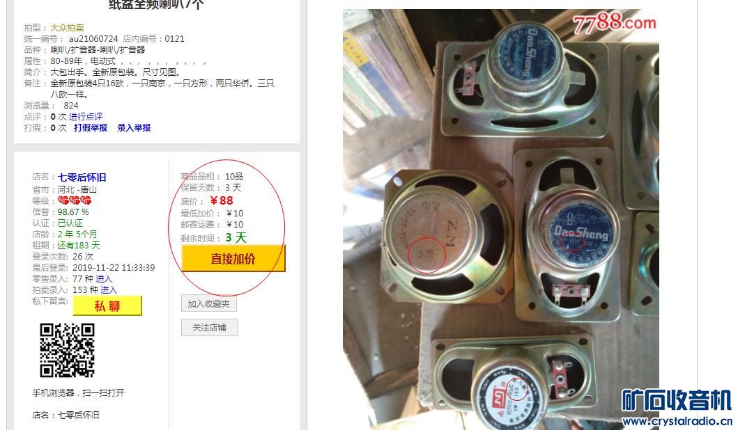

再弄个8欧的高音串可以吗?
https://www.997788.com/pr/detail_auction_407_21060724.html
