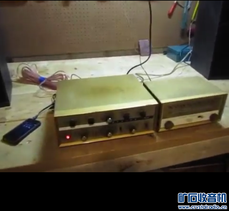

哪位老师知道这个电子管收音机是啥牌子,收音效果媲美车机,若在能给找到电路图就...

看下机器内部有没有型号之类的信息,美国机一般都有个小的示意图在机器里,如找到这个,离找到图纸就不远了。

没有啊,我觉得应该和EABY上那个图纸差不多

型号不好找 型号找到了资料还好找一点  眼都花了 来瓶眼药水吧~    REALIST T-III
Country:         United States of America (USA)
Manufacturer / Brand:         Radio Shack (Tandy, Realistic, Micronta); USA
Year: 1959         Category: Broadcast Receiver - or past WW2 Tuner
Valves / Tubes        7: 6BS8 6AB4 12AT7 6AU6 6AU6 6AU6 6AL5
Main principle        Super-Heterodyne (Super in general); ZF/IF 10700 kHz
Wave bands        FM Broadcast Band Only
Details
Power type and voltage        Alternating Current supply (AC) / 110 - 120 Volt
Loudspeaker        - For headphones or amp.
Model: Realistic T-III - Radio Shack Tandy, Realistic,
Material        Metal case
Shape        Tablemodel, with any shape - general.
Notes        AC operated FM tuner.

雷神的收音头,单声道输出。
