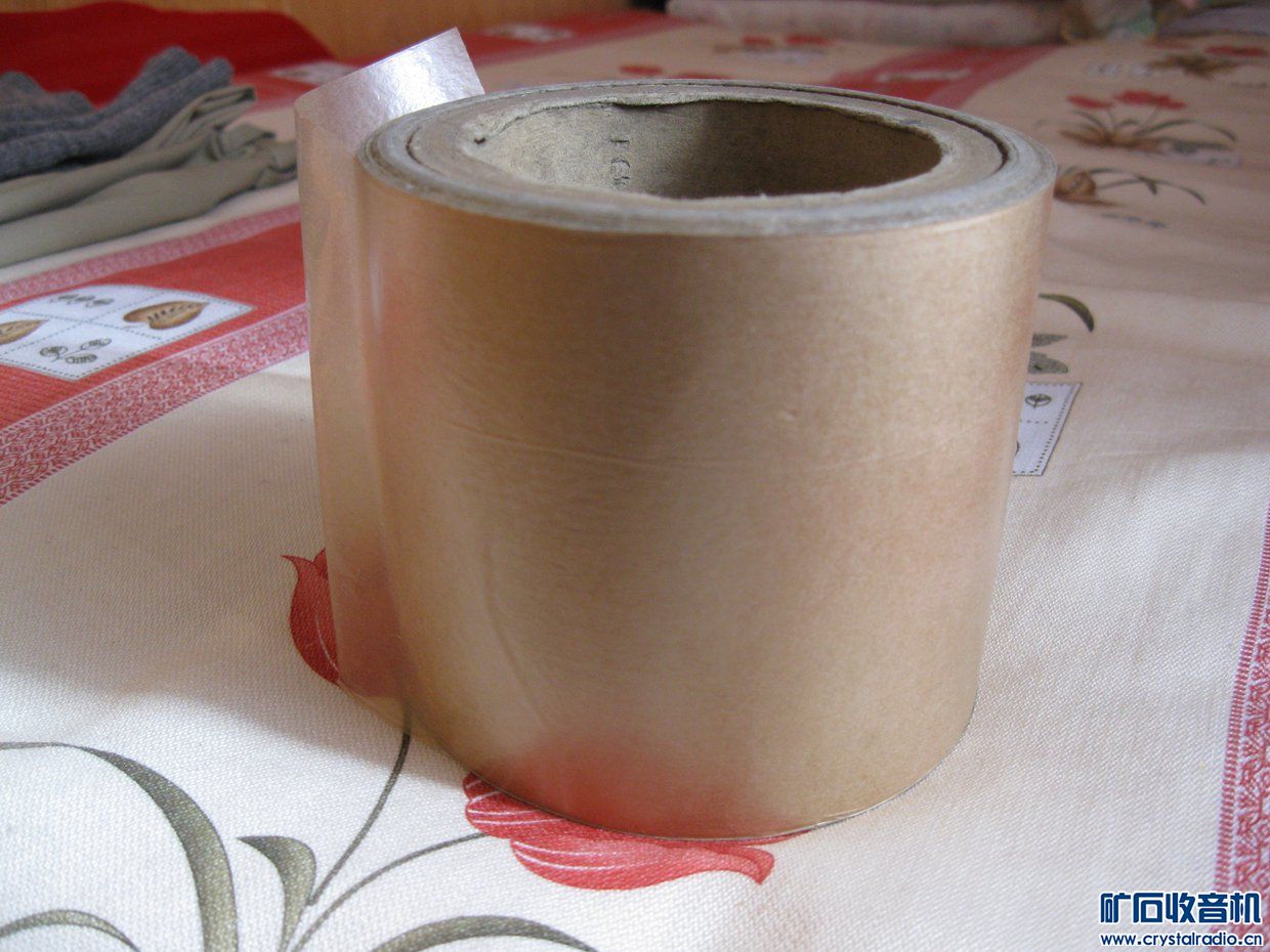

发表于 2015-2-8 12:29:38 | 显示全部楼层
没那么多规格的绝缘纸,只有0.01的电容器纸,0.05的电缆纸,0.04的聚酯薄膜,0.28的青壳纸和黄蜡綢这几种,0.01的电容器纸有点薄,绕到最后不够宽了还要加一小条.   这是在旧货市场买的0.01的电容器纸,才花了一块钱,95mm宽,一般都够用了。 IMG_1723_副本.jpg        IMG_1727_副本.jpg
